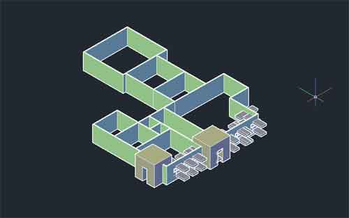

How do I make my doors and windows look normal? The windows are the default 3'x5' and the doors are a default 3'x7'. Also when looking at the house plan in birds eye view, the windows are not visible.

I gotta say that at this point in time, they are looking pretty custom!

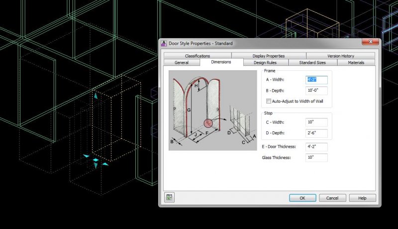

Well I think I found your problem...
Your door and frame dims are "a bit" off ;)
Select your item in a 3D view and then click on "Edit Style" in the panel above. Here you will get this dialog box to make the needed changes to your door and window styles.
That's it! For some reason that's what cad is defaulting to. I changed my settings on my drawing and that solved my problem. But then I opened a new drawing, drew a wall and added a window...same problem. 10" glass again!
Is it because I'm not starting off with a template?
