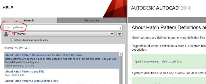

http://docs.autodesk.com/ACD/2014/ENU/
If you do option 1 be mindful of the separation characters between each pattern.
Unfortunately that link got me nowhere (a blank screen).
Perhaps you have to type in the search box :shock:
I did. There seems to be a problem with my Help file. When it has happened I find an answer some other way.

It would work. My aplologies for that unhelpful link to the 2014 help, ReMark. Here's an extract:
