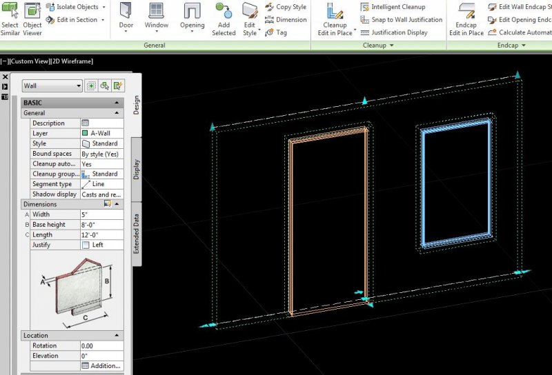

f700es Posted October 4, 2013 Posted October 4, 2013 Well a 3d object in vanilla autocad will not be the same type of 3d object as it is in AutoCAD Arch. Now if you create a 3D solid in vanilla and open it in Arch yes it is the same type of object. The 3D architectural objects in arch will be AEC objects with data behind them. Perhaps this is what Tekla needs. Quote
stevsmith Posted October 4, 2013 Posted October 4, 2013 mmm, I suppose that could be confusing ?:? even though the verticals would import the dwg formats, the model properties wouldn't be the same. And I don't see vanilla on the list. You could give them a call. Quote
ReMark Posted October 4, 2013 Author Posted October 4, 2013 Good point f700es. The AEC objects must have some "intelligence" that would be missing with AutoCAD 3D objects. Thanks. Quote
