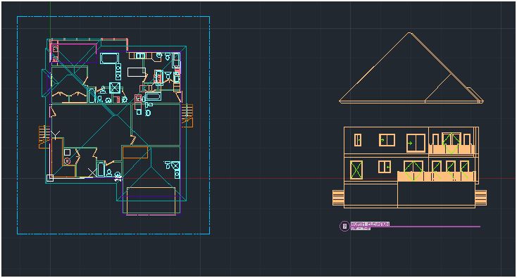

Have been using Project Navigator, built a three story structure... went to create a 3D Model and my roof appears to be floating a good distance above where it should be! See Picture!Floating Roof.JPG Went through each of the floors and clicked on properties and they all appear to have the correct Y setting but nothing...
At one point was able to move the roof to sit where it was supposed too, but when I generated my elevations, it was back in the air?
Suggestions?
I have more pictures with the properties of each floor but didn't want to bog down the system by uploading 6 pictures!o:)
Thanx for reading!

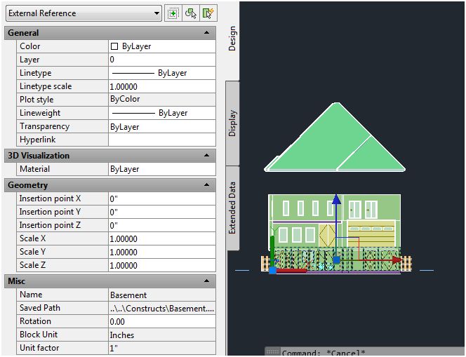

When you create your Levels, you must ensure the Constructs are being built on the proper Level. Have you gone back and rechecked each elevation, and which Construct is associated with the proper Level?
What happens is when you create the final model, it XREF's each Construct in @ a Z elevation based on the Levels selected. Check those and reply back. Also, don't be shy in uploading images... do as you please! :)

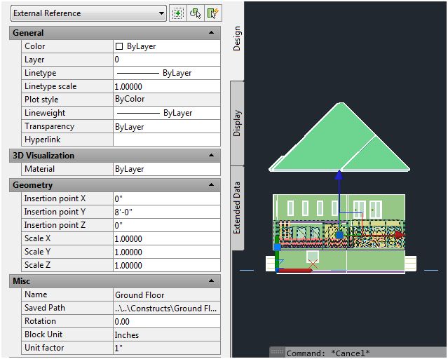

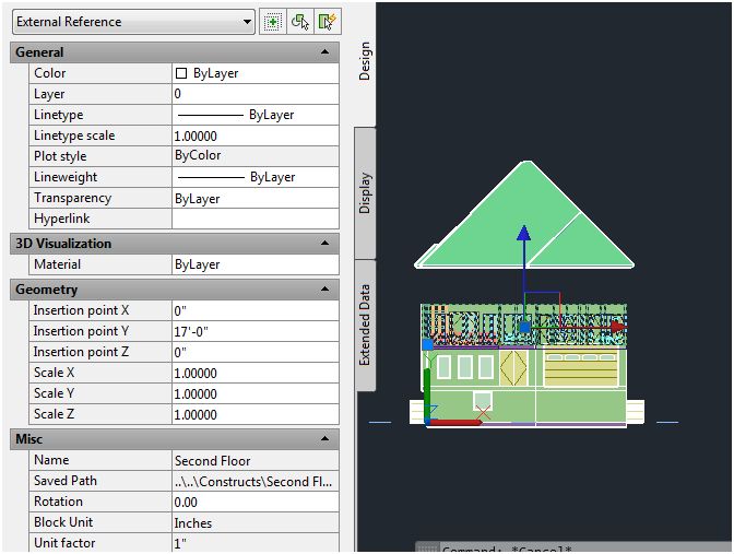

TXF, So here is what I have:Main Floor with Properties.JPG And the end result is visible in ALL levels.. LOL
Thoughts?

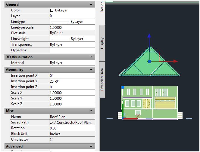

Seems to me that your Constructs are importing just fine. Are you certain that your roof isn't higher than in should be in the Construct file? Any offset applied by chance? The reason I assume is because the insertion basepoint of the Construct seems to line up with the top of 2nd Floor just fine.
