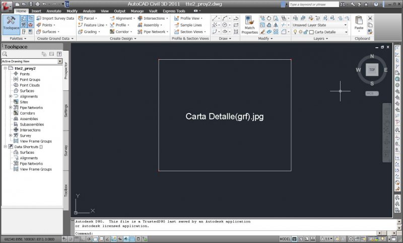

When I open my drawing in Civil3D, the image comes up as a rectangle with its name on it.
It's not an image anymore.
Just the name of it.
[ATTACH=CONFIG]44330[/ATTACH]
How can this be?
I've had problems like this before which were caused by the filesize of the image being too big. What is the filesize of the image you are inserting?
Make sure the lmage file is in one of the folders in your support paths.
The carta_detalle.jpg (detailed chart) map is a little big (7 MB).
But the AutoCAD drawing file will get even bigger because I have to georeference two more maps behind that one (which are even bigger).
I try saving my images at medium size in photoshop to reduce the size at least a little bit. Alas, I can't save as low quality ... the contour lines would have been too blurry.

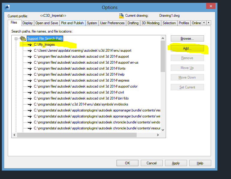

How do you do this?
Could you please explain further?
In the options, under supporting files add your folder for the image(s). Also depending on the image type you may need to add the object enabler for Raster files.
