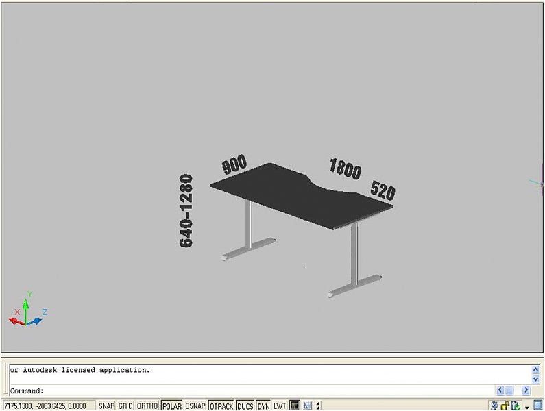

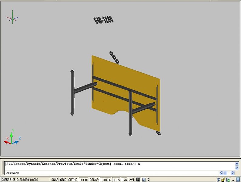

Hello Mac
I have a problem with the lisp , when i am insering the autocad file the its not getting inseted in its original(its geting rotated)
i have attached picture1 and picture2 for reference..
picture1 is original dwg file.. picture2 is by using lisp
Hi Sham,
try this, let me know if it resolves the issue:
    .: Multiple Block Insertor :.
        .: by Lee McDonnell :.
         .: December 2008 :.
; Version 1.1 ~ UCS code added.

thanks leee:)
it is resolved now
regards
