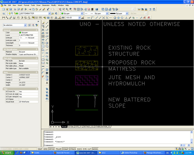

I'm trying to apply the honey hatch to my drawing, yet when I use the hatch, it appears as a random pattern of lines rather than the hatch I have chosen.
When I change the rotation of the hatch to try and correct it, I cannot seem to find the angle which allows the hatch to appear normal.
I've included a screenshot of my problem. The hatch I'm referring to is the 'EXISTING ROCK STRUCTURE' rectangle.
Your help is appreciated.

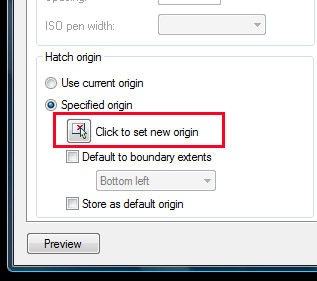

this may happen if your hatch area is not close to 0,0,0
use specified origin while doing hatch & put it closer to the rectangle you are hatching. or move your drawing closer to 0,0,0
