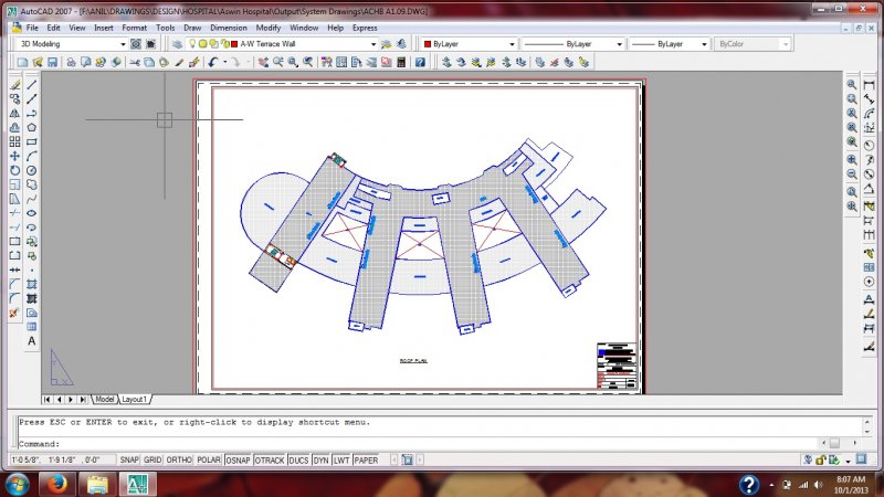

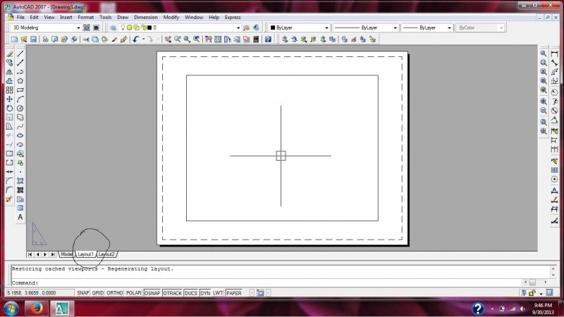

anil130 Posted September 30, 2013 Posted September 30, 2013 Hi frends.. would any body guide me how to make the drawings on scale on layout. i have attached the pics of it also.. Quote
ReMark Posted September 30, 2013 Posted September 30, 2013 Not much to work with there anil. How about attaching an actual DWG file to your next post? Are you working in metric units? What scale are you expecting to use? Are you familiar with viewport scaling? Quote
mdbdesign Posted September 30, 2013 Posted September 30, 2013 Delete existing viewport -go to page setup and setup new page for printing -create new viewport (_-vports enter for default "Fit") -select viewport -open properties (ctrl+1) -change standard scale to suit. Quote
ReMark Posted September 30, 2013 Posted September 30, 2013 I'd suggest creating a separate and distinct layer for your viewport(s) and make sure the layer is set to "no print" in your Layer Properties Manager. anil: Do you know how to set a viewport's scale? BTW...your image shows you are using AutoCAD 2007 and not Mech 2009. Is that what you'll be sticking with for the time being? Quote
anil130 Posted October 1, 2013 Author Posted October 1, 2013 Hi.. Many thanks for the quick reply. Mark: i have attached the drawings, i want the drawings on the template on layout on scale, as soon as in the picture. if kindly tell me how to make the template on layout then it will be highly obliged.. Quote
ReMark Posted October 1, 2013 Posted October 1, 2013 anil: You have attached an image which is not the same as an actual drawing file. Furthermore, you have neglected to answer almost all the questions I have asked thus far. It is difficult to assist a person when they refuse to provided the necessary information. Well it seems at least you have the building within your viewport so what is the exact problem here? Have you set the scale yet? If so, what scale did you use? Re: Viewports. You might benefit from reading this... http://www.cadtutor.net/forum/showthread.php?72972-Things-you-should-know-about-Viewports.&highlight=viewport+scale Here is a link to something I wrote about Viewports and setting their scale (images included) you might also find useful... http://www.cadtutor.net/forum/showthread.php?72213-Viewports-and-Setting-Scale&highlight=viewports Quote
anil130 Posted October 2, 2013 Author Posted October 2, 2013 Dear Remark:, you are right i had attached different file, because i want to show you that the drawing was in scale in layout with the template on A3 size. and i had never neglected your question, furthermore i am very much curious to learn new things.and many thanks for the warm information. anil: You have attached an image which is not the same as an actual drawing file. Furthermore, you have neglected to answer almost all the questions I have asked thus far. It is difficult to assist a person when they refuse to provided the necessary information. Well it seems at least you have the building within your viewport so what is the exact problem here? Have you set the scale yet? If so, what scale did you use? Re: Viewports. You might benefit from reading this... http://www.cadtutor.net/forum/showthread.php?72972-Things-you-should-know-about-Viewports.&highlight=viewport+scale Here is a link to something I wrote about Viewports and setting their scale (images included) you might also find useful... http://www.cadtutor.net/forum/showthread.php?72213-Viewports-and-Setting-Scale&highlight=viewports Quote
ReMark Posted October 2, 2013 Posted October 2, 2013 It was not immediately apparent that you had the drawing at the desired scale. Do you have any further questions regarding viewports? So, what's next? Have you printed out your drawing(s)? Quote
