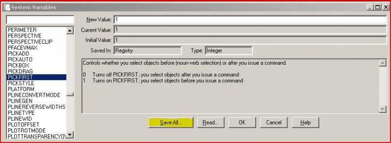

Dadgad Posted September 29, 2013 Posted September 29, 2013 Although not impossible, I doubt your users settings were changed by merely opening a drawing. The symptoms you described are all controlled by the PICKFIRST variable. Change it to "1" at the command line, or in Tools > Options > Selection > Noun/Verb Selection Welcome chester, to CADTutor. A nice bit of deduction there nestly, guessing/assuming that you will prove to be right. Chester, should nestly have solved your problem, and you find your variables to be back on the tracks? I strongly suggest that you type SYSVDLG at the commandline and hit ENTER to call up the System Variable Dialog, a wonderful tool, a library of most of the available system variables, detailing the numerous optional ways they can be set, to customize the behavior of the software. At the bottom of the box you can SELECT ALL, creating an .svf file, which will have all of the current System Variable Settings, put it somewhere you can find it, in case you ever need it, or want to install your System preferences on another computer. I hope nestly was right, and that you are now back in the game. On the off chance that you may not have already set one up, I suggest you also set up a Profile with how you like things, on the Profile tab in OPTIONS. Quote

Dadgad Posted September 30, 2013 Posted September 30, 2013 Very glad that your problem was so easily remedied. I must admit that the rather odd, perhaps ominous sound of the purported creator of the drawing you described had me concerned that somebody had gone out of their way to create a devious new way to screw up Autocad, for all the rest of us. That mission seems a bit redundant, and is one which I think is best left to the PROFESSIONALS in product design at Autodesk! In all fairness though, lots of the stuff they come up with actually IMPROVES the software experience. Remember to save your comfy old armchair settings (.svf), and if you really feel daring, take some time and look at a few of your favorite system variables in the SYSVDLG, who knows, you might just decide to fluff those old down cushions with a new option twist or two. As long as you have your .svf saved, you can always easily reset them if you need to. Quote
