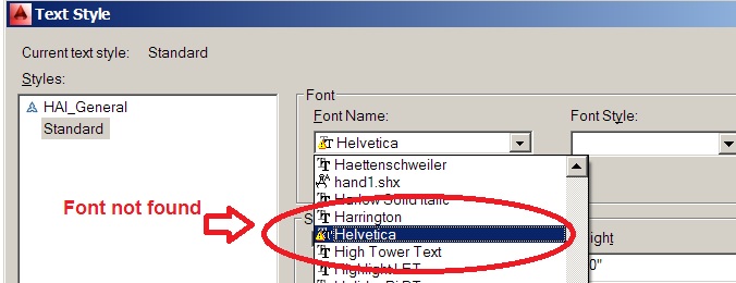

I'm using AutoCAD2014 at the momment (not ACA) and I don't see the distorted text, however I also don't have Helvetica font installed, so AutoCAD is automatically substituting another font.
Autodesk Knowledge Base --> AutoCAD Substitute Fonts

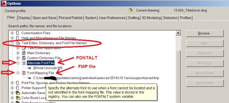

Can you confirm whether the other users in your office have Helvetica, and even if they do, perhaps it's still being substituted on their machines via AutoCAD's substitute font file. (If Helvetica is referenced in their acad.fmp file, then it's likely not actually being used)

Unfortunately, they have the same fonts and the same alternates/fmp paths that I do. Also on my machine, Autocad is not displaying that the font is missing (no warning icon) in the text styles dialogue box.
