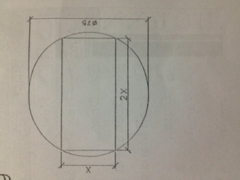

Hi all,
I am learning autocad by myself, right now I am stucked on a self-learning exercise.
I have no idea how to draw an inscribed rectangle like this, which its length is 2 times its width. just hope someone can teach me :surrender:

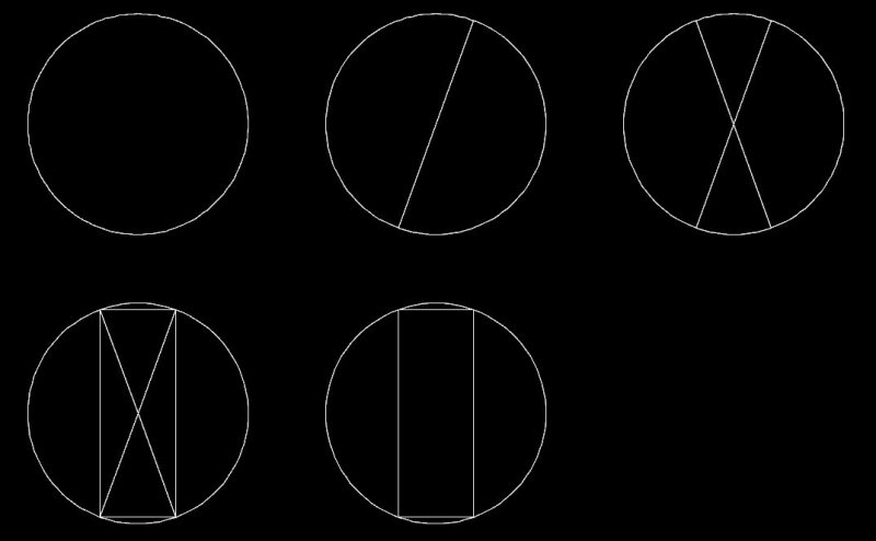

My non-mathematical approach.
I like this one better. I used the Circle, Line, Extend, Mirror and Rectangle commands. I also included the finished version.

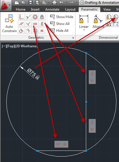

Since you are using 2014 you can find a Parametric solution.
Create the circle and add parametric diameter dimension.
(become familiar with Nearest osnap which will give you Coincident constraints)
Draw horizontal line.
Draw half vertical line (don't worry about getting it exact size).
Draw second half vertical line.
Make the vertical lines Equal (=) constraint equal to the horizontal line.
AutoCAD parameters.png You can now test by editing the circle diameter.
X=33.541019662

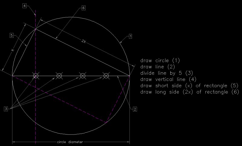

Thanks for all :) I tried the paulmcz's method, it really works, the length is 2 times to the width. thank you so much.

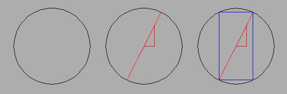

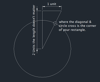

Even another way.
First of all draw the circle.
Then from the centre point, draw a horizontal line 1 unit (or multiple), then a vertical line 2 units and then close the triangle. Extend this diagonal line until it reaches the circle at both ends. Use the Rectangle command with the pick points at each end of the diagonal line.
I assume then that Perpendicular wouldn't yield the solution you were after?
Also, love that solution Eldon. :D
oh cool, eldon's method works too. :thumbsup:

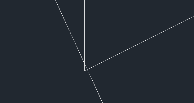

anyone know how to make the corner of the rectangle perfectly line on the circle? as I zoom in, there are no intersection point between the circle and rectangle, [i uploaded a "zoom in" in previous post]
If you hit RE you may find that when regenerated they do intersect.
If not you can scale up the line from the center of the circle by a random amount
to ensure that they do intersect. Then use the Rectangle command starting
from one Intersection Osnap point to the other, case closed, done deal.

[ATTACH=CONFIG]44165[/ATTACH]
err...its not easy to self-learning cad, i feel so noob :cry:
I have only been CADing since 2006, and I feel like a noob too. Besides, I never took any advanced math classes beyond plane geometry.
You need to draw the rectangle at the 1:2 relationship before scaling, and then make sure the aspect (x,y) ratio stays while scaling. Still, accuracy depends on how well one can handle scaling to a reference. Mine is not the best solution.
