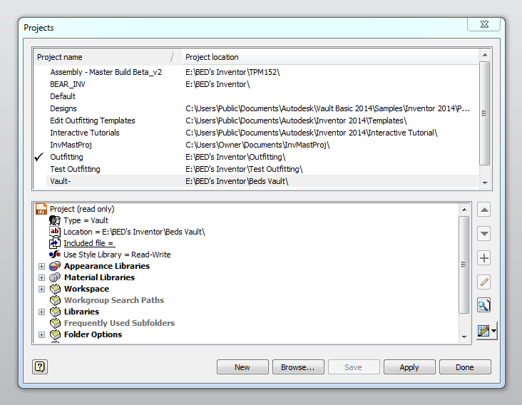

beardrafter Posted September 25, 2013 Posted September 25, 2013 I'm setting up vault and networked settings for Inventor 2014. When I start a "New Vault Project"... after a few days or so.. it turns into a (read only) project and i can't adjust any of the Folder Options or File locations. It doesn't matter if i have another project selected as current or if i'm logged into Vault or not. I have all Admin uses on the vault and the computer. Other Single User projects are ok to adjust. I'd hate to have to create a New project everytime I want to adjust something. Does anyone know how to keep vault projects open to change? Is this a default setting after you create a vault project... you can't change it? thanks Quote
beardrafter Posted September 25, 2013 Author Posted September 25, 2013 I figured it out... just find the Project.ipj file on the hard drive and RC for properties and uncheck the "Read Only". I guess vault might change it to read only. Quote
PotGuy Posted September 26, 2013 Posted September 26, 2013 That's strange behaviour. It sounds like it's just your account. Has it happened to over projects since you unchecked it, or have you had to do it for other projects? Quote
beardrafter Posted September 27, 2013 Author Posted September 27, 2013 it seems it only happens to a vault project. and yes it continues to change the project.ipj to "read only" Quote
