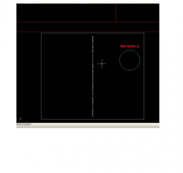

ismiflori Posted September 25, 2013 Posted September 25, 2013 I've attached pictures in the cad file.. but once it was sent through email.. picture is gone... how can i attached pictures in the file in such a way that it won't be lost even if i send it through email... see attached file.. it appears like this after sending it... Quote
edwinprakoso Posted September 25, 2013 Posted September 25, 2013 You need to insert the image as OLE object. Open an image editor (MS Paint is good enough), open the image. Select all then copy to clipboard (ctrl + C) Then paste the image in your AutoCAD drawing. You can use ctrl + V or PASTESPEC. Quote
satishrajdev Posted September 25, 2013 Posted September 25, 2013 (edited) Save that image on your directory where you have saved your drawing... By external reference reload that image file. it will get attached to the box automatically where you have kept previously. and if you want to send drawing by mail then keep image file in attachment to open drawing properly with image file in other system, otherwise it'll give same error which you got now. Ping back again If you have any more doubts regarding this. Edited September 25, 2013 by satishrajdev Quote

rkmcswain Posted September 26, 2013 Posted September 26, 2013 ismiflori said: I've attached pictures in the cad file.. but once it was sent through email.. picture is gone... As the title of your post indicates, images are references, not embedded in the drawing file database. OLE images are embedded, but have problems of their own. Just use etransmit and send the referenced image along with the drawing. There are also 3rd party tools that convert the image to native AutoCAD geometry. Quote
