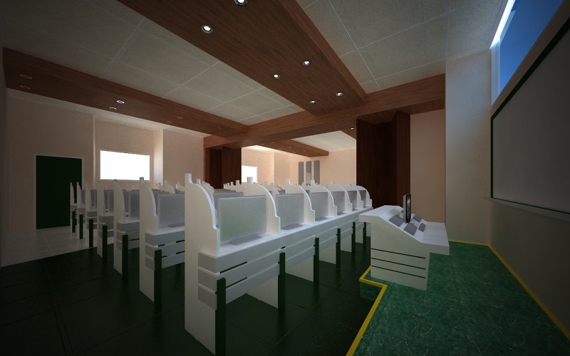

hey everyone,
i am currently rendering an interior and when i place a light to illuminate the space, and test render it, the center of the image is the one brightening up, if i add more lights, that center will just grow brighter and brighter, until it will be over burned. but when you look at the location of the light source, its dark as if the it magically glows at the center of the image instead..
please help..thanks all

i was hoping that would just be the problem and by creating a new file, it will fix everything but here is what came out.
p><p><img src=[/img]
well, i didnt place any lights at the bottom right portion of the room but it seems to be emanating light from that direction. and if i increase the value of the lights, or adjust to a brighter f-stop, or increase the primary bounce which is irradiance map, or anything to make it brighter, the bright portion on this image just gets brighter.
the first image is actually test rendered several times and its my final image to submit to the dean, they care more about the design anyways but if he notices the lights well then i have to really figure this out.. lol

Can you post full size images? I can't tell anything from those little thumbnails.
Also, you didn't answer my question about the lights. Are they studio max lights or were they imported from Autocad?
And where are your lights located? It would be good to see a wireframe screenshot so I can see the light locations.
can you please suggest a good image hosting site?,thanks, all i found in google are crap!. they reduce the image size and place a very big watermark in the middle.
i used vray ambient light for this, i didnt know you could import lights from autocad to 3ds max, i try that one soon...thanks for bringing it up:)
i placed the lights inside the pinlight fixture which are located on the dropped ceiling part, the one with the wood material in the ceiling, i subtracted a cylinder to the model of that dropped ceiling to where the pinlights would be so as not to bury the light and the fixture.
the bright portion is what troubles me, i have no idea why its there and why its not bright at where the pinlights are.
