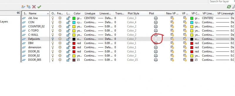

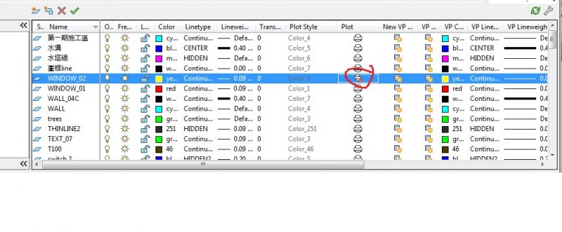

cmuraztaz Posted September 22, 2013 Author Posted September 22, 2013 sir i found some template files and i don't know how he do this.. and if i click the plot this is what happen.. can anyone teach me how to figure this out..its big help to me... and thanks to quick reply for every one.. Quote
mikekmx Posted September 22, 2013 Posted September 22, 2013 (edited) the column you have circled stuff in......that 'plot' setting determines if the layer is plotted or not (defpoints layer is set by autocad as a no-plot layer and cannot be changed, but other layers can be plotted or not plotted as you wish). stick your vp on a non-plot layer. leave it there. if you want a viewport border (sometimes it's nice to have one,sometimes not), then draw one over your vp border on a plotting layer (and EG name it 'Titles') reserve no-plot layers for stuff you never ever want to plot....eg i use mainly 2 no-plot layers, vp and dims (where i put my construction geometry rather than dims as such). generally the plot/no-plot setting is then left aone. the visibility of other objects is usually controlled by freezing/thawing - either globally or 'per viewport'.. have a play on a new drawing. hth post #7 explains it quite well doesn't it? Edited September 22, 2013 by mikekmx Quote

Dana W Posted September 22, 2013 Posted September 22, 2013 The Layer properties manager is displayed in post #8. Can you open it in your program? Quote
ayethzerothree Posted September 26, 2013 Posted September 26, 2013 just give your viewport a layer name (say for example vp ) on the layer table find the layer vp then click the small icon same as printer then thats it. your view port now is not printable. have a nice day Quote
