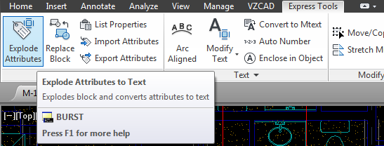

Sbeth85 Posted July 22, 2014 Posted July 22, 2014 BURST is an unknown command in my version, AutoCAD 2014. What is it exactly? I didn't understand what you meant about leaving the attribute blank... you basically mean keep the whole title block as a block, and then after I insert it into a drawing, them going and manually making a text box and typing in what I want? (Otherwise I don't understand... why would I make an attribute and then leave it blank?) Quote
RobDraw Posted July 22, 2014 Posted July 22, 2014 BURST is an unknown command in my version, AutoCAD 2014. What is it exactly? It shouldn't be unknown. Do you have Express Tools loaded? (I'm not even sure it is an Express Tool anymore.) It's like explode but it treats attributes differently. It changes them to text and maintains the value that was input. I didn't understand what you meant about leaving the attribute blank... you basically mean keep the whole title block as a block, and then after I insert it into a drawing, them going and manually making a text box and typing in what I want? (Otherwise I don't understand... why would I make an attribute and then leave it blank?) Exploding a block with attributes is not a good thing. The attributes do not change to text. Attributes want to be associated with a block. I've seen situations where having just one unassociated attribute caused major issues. Quote
