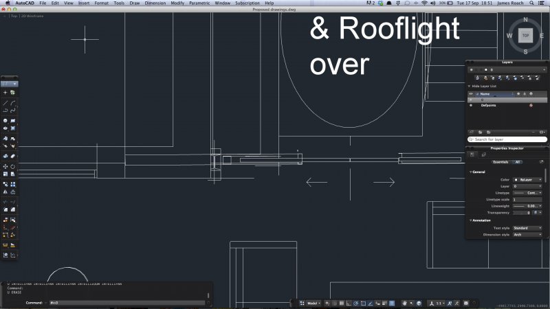

jamroac Posted September 17, 2013 Posted September 17, 2013 Hello Please excuse my first post being a whiny problem but I'm getting pretty desperate! Also sorry if this has been answered elsewhere. I am tasked with tidying up some drawings that have been exported from Vectorworks and it seems there is a fundamental problem with the drawing. Some lines do not appear when viewing the drawing, they only appear when panning or when I select all. There are some cases where a line disappears behind a rectangle as if it had a hatch fill yet no such thing exists. I have attached the drawing in question. I am using AutoCAD 2012 for Mac. All and any help will be greatly appreciated! Thank you. Proposed drawings.dwg Quote
ReMark Posted September 17, 2013 Posted September 17, 2013 Maybe the objects are hidden by a wipeout? Test my theory. Change the value of the system variable FRAME to "1". What happens? Do they now appear? Quote
jamroac Posted September 17, 2013 Author Posted September 17, 2013 Ah! It has made some of the lines appear solidly however some of the lines are still disappearing. Is it trial and error to get a correct value for the FRAME? (It was set to 3 previously). Thank you for your help. Quote
ReMark Posted September 17, 2013 Posted September 17, 2013 Just a lucky guess on my part. Some lines/objects still aren't visible? In what area of the drawing? OK...so I took a look at your drawing, found some of those mystery objects you alluded to then decided, since you brought the drawing in from another program, to run the OVERKILL command on it. Out of 2774 objects that were found, 136 were duplicates and 328 overlapped each other. Ran it a second time and AutoCAD found 2424 objects, no duplicates and no overlapping objects. Maybe some of those other objects you only saw briefly were duplicates? Upon closer inspection this drawing is going to require a lot of work to clean up. Lines are not straight (horizontally or vertically) in many cases and there are lots of bits and pieces of lines scattered here and there. Hope you have some time on your hands. Quote

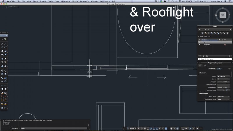

jamroac Posted September 17, 2013 Author Posted September 17, 2013 Well it seems to have sorted the majority of the issues, there is only one isolated incident it seems. I've attached screenshots of the problem, first is when the view is still, the second is when panning. Seems very odd. Quote

jamroac Posted September 17, 2013 Author Posted September 17, 2013 Sorry, the issue is that some of the lines aren't present when the drawing is idle, then when I pan, as the second screenshot, lines magically appear. I am aware of the scruffy nature, unfortunately this is not due to the conversion but to the original drawer of this file! However I do not have the time, or tools necessary to start from scratch so I will have to persevere with trying to clean it up. Thank you for all your help and insight, I think I will have to grin and bear it. Quote
rkent Posted September 17, 2013 Posted September 17, 2013 jamroac, ReMark proved that wipeouts are the issue, use quick select in properties to isolate them and delete them. That drawing is a mess, good luck. Quote
jamroac Posted September 18, 2013 Author Posted September 18, 2013 Hi guys. Thanks for your help. I turned WIPEOUT frames on which exposed all the problem areas and deleted them just as you said. Problem solved! Quote
