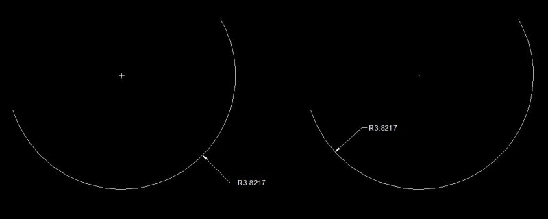

Tuns Posted September 17, 2013 Posted September 17, 2013 The standard in the industry I work in is the radius dimension goes on the inside of the arc. However, AutoCAD defaults the dimension to the outside of the arc. Is there a way to make it default to the inside? If not then this is the issue when I use the mirror command. [ATTACH=CONFIG]44015[/ATTACH] That arc appears and I cannot get rid of it. Quote

Tuns Posted September 17, 2013 Author Posted September 17, 2013 [ATTACH]44017[/ATTACH] There you go Steven. It's just the standard radius dimension we use. Quote

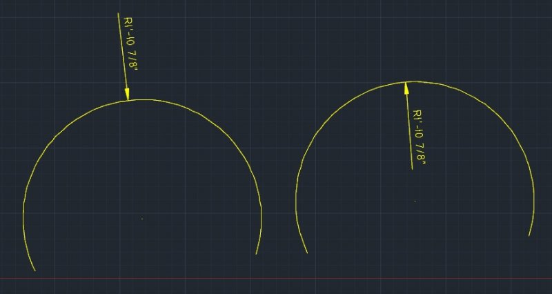

Barneel Posted September 17, 2013 Posted September 17, 2013 Maybe I misunderstood, is this what you are trying to do? Quote
Tuns Posted September 17, 2013 Author Posted September 17, 2013 No you didn't. I can't figure out how to move it to the inside. Oh... Okay I got it now... I'm so stupid. Quote

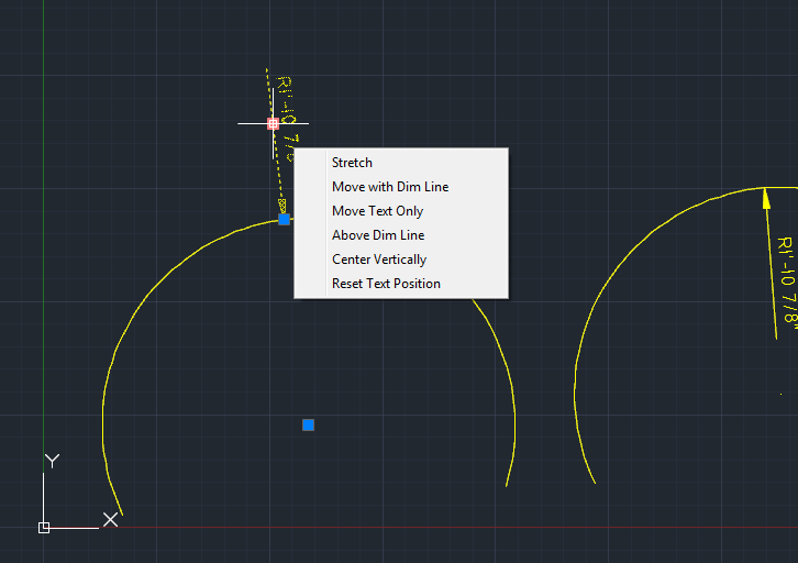

Barneel Posted September 17, 2013 Posted September 17, 2013 Can you use the hover grip option "move with Dim Line"? Quote
Tuns Posted September 17, 2013 Author Posted September 17, 2013 Yeah, I'm still new to AutoCAD so I didn't know you could actually just flip it over like that. Quote
steven-g Posted September 17, 2013 Posted September 17, 2013 You can use the grips on various dimensions, it can be quite useful sometimes. Quote
