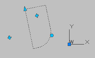

  nestly said:
To eliminate as many variables as possible, we should be using the same dwg and the same settings, and the same selection method. The video I made was with drawing in post #16 and BACTIONBARMODE = 1 and a crossing window.
I changed BACTIONBARMODE to 0 because someone suggested it. However, I set it back to 1 and have created a new drawing - with far more success. Drawing is attached.
The only problem here is that the grab handles don't move with the block.
There is progress. At least the distortion thing after rotating is gone.:)
BTW: all the selections were done with crossing window.
Sofa - BACTIONBARMODE=1.dwgFetching info...
Treat the Parameter Grips in the block editor as if they were any other object. In order to flip, stretch, or rotate grips, included them in the action selection sets.
