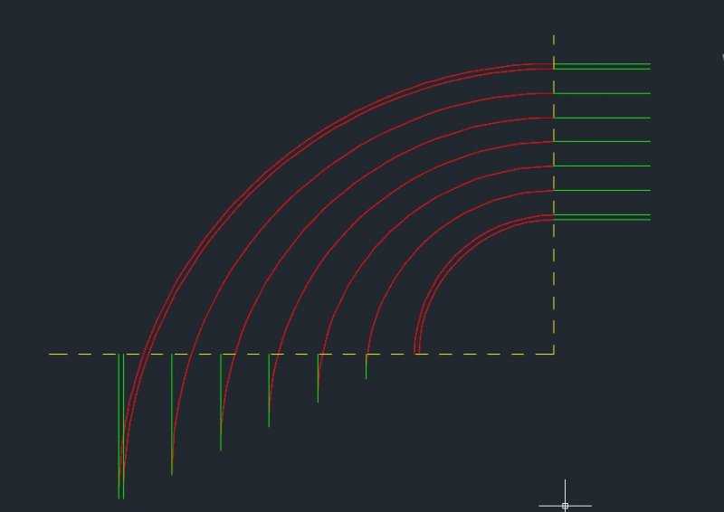

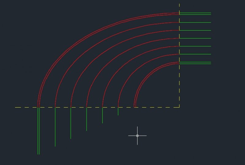

Barneel Posted September 16, 2013 Posted September 16, 2013 I bet this is easy as pie, but the arcs just won't behave! I need an arc that is required to be tangent at both ends. I've attached a picture that will hopefully help explain what I'm trying to do. The red lines are the arcs, the green lines are the lines I want the arcs to be tangent with and the yellow dashed line is the point at which I want the arcs to end. Thanks! Quote

nestly Posted September 16, 2013 Posted September 16, 2013 If I understand correctly, the endpoints are different distances from the "center" so it can't be an arc. Ellipse with different X major and Y major radius perhaps? Quote
Barneel Posted September 16, 2013 Author Posted September 16, 2013 Potguy: I wouldn't imagine so. Mainly because the arcs I'm trying to create won't have a linear radius due to their tangents, which will make them more of an oval Quote
SAFeSTeR Posted September 16, 2013 Posted September 16, 2013 I don't think FILLET will work if the x and y distances are different. Perhaps you could try drawing ellipses using the point where the 2 dashed lines meet as a centre point then trimming off what you dont need? EDIT: The quadrants of the ellipses to be placed at your required tangent points. Quote
Barneel Posted September 16, 2013 Author Posted September 16, 2013 Aha the ellipse idea is a good one! I'll give it a go Quote
Barneel Posted September 16, 2013 Author Posted September 16, 2013 Ellipse brilliance! Thanks a lot! Quote

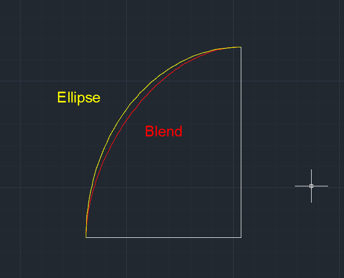

Barneel Posted September 19, 2013 Author Posted September 19, 2013 Another good suggestion. Interestingly it creates a different result with a slightly more harsh transition into the tangent. I suppose because it's goal is to reach the tangent and nothing more, as opposed to the ellipse which continues afterwards. But I still would have expected the same results Quote
rkent Posted September 19, 2013 Posted September 19, 2013 There are options under that command and you can pick on the vertices and manipulate the object. Just shows that there are lots of solutions that are all tangent to the two lines. You can add vertices by hovering over the blue circular grip, see other options there as well. Quote
Barneel Posted September 19, 2013 Author Posted September 19, 2013 Ah, "continuity", makes sense now I let it pass through my brain properly. Neat feature. Quote

nestly Posted September 19, 2013 Posted September 19, 2013 Use the BLEND command. So I read that and said "What? ... that's not a real AutoCAD command!" but it works in 2012 and newer. Cool Quote
