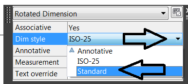

jdavid10 Posted September 12, 2013 Posted September 12, 2013 Hello everyone, I'm making this diagram of the load condition acting on tunnels to explain a Japanese set of equations that are used for the structural analysis for tunnels: But, there is one problem I have. I'm trying to set up the text for the dimension between the water table and the tunnel "Ha" to look horizontal. However, if I click on the properties box and write 90 in the rotation box right next to where it says "text rotation," the dimension text does not rotate 90 degrees; if instead I try to rotate it 180° then it only rotates 90° (and in the opposite direction) instead of 180°. It doesn't matter how many degrees I choose, it won't rotate my dimension "Ha" to desired angle to make it look horizontal. OK I know it's hard to explain my problem with just writing, so I've posted a few pictures: In this one, the dimension is at 0°; I've only opened the properties box to attempt and rotate it: Now I write 90 in properties box but the dimension text does not rotate at all; it remains at 0 as it is shown in the following image: Next I try to rotate 180, just to see what happens; and it does rotate (only 90 degrees!): I finally try to rotate the text 270 just to see if it rotates to desired angle and it does rotate (180 degrees from original position). As shown below: It doesn't matter how many degrees I choose, I cannot make it look horizontal. Is AutoCAD wrong? Or am I wrong? lol xD Any ideas? I'm about to loose a quarter pound of my hair from just thinking about this. Lol just kidding but this is very annoying. How can I set up my dimension text "Ha" to look horizontal? Please help. Quote
JD Mather Posted September 12, 2013 Posted September 12, 2013 What happens if you click on the dimension and change from ISO to Standard? Quote

jdavid10 Posted September 16, 2013 Author Posted September 16, 2013 What happens if you click on the dimension and change from ISO to Standard?[ATTACH=CONFIG]43942[/ATTACH] Hi JD Mather Thanks for the help. It solved the problem. But how come it does not work with ISO-25? Do you know? Quote

rkent Posted September 16, 2013 Posted September 16, 2013 But how come it does not work with ISO-25? Do you know? Compare the two dim styles, looking at the Text tab, text alignment. ISO is set to aligned with dimension line, the other one is Horizontal. Quote
jdavid10 Posted September 17, 2013 Author Posted September 17, 2013 Compare the two dim styles, looking at the Text tab, text alignment. ISO is set to aligned with dimension line, the other one is Horizontal. Oh ok, I thought that "aligned" only meant that the text could have any direction (but within the dimension lines). So, the orientation of the text in ISO-25 is set to be fixed within the dimension lines then. (?) Quote
