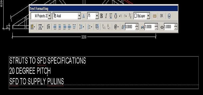

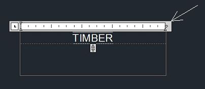

MisterJingles Posted September 12, 2013 Share Posted September 12, 2013 Hi all A fellow cagemate is having some trouble with his Text Editor and I swore I'd (Cadtutor) solve it for him. See images below, the top is of the Text Editor as it usually is with the width adjustment ruler on top, the bottom image is taken from his ACAD which as you can see does not have this ruler. This happened yesterday and we have not managed to restore it back to how it was. Has he turned it off somewhere? How can he get it back? Thanks Rob Quote Link to comment Share on other sites More sharing options...
ReMark Posted September 12, 2013 Share Posted September 12, 2013 Set the variable MTEXTTOOLBAR to a value of 2. Quote Link to comment Share on other sites More sharing options...
MisterJingles Posted September 12, 2013 Author Share Posted September 12, 2013 Hi ReMark, it isn't so much the Text Formatting window which is the problem but rather the "ruler" as pointed out by the white arrow in the top image. The MTEXTTOOLBAR variable is set to 2. Quote Link to comment Share on other sites More sharing options...
ReMark Posted September 12, 2013 Share Posted September 12, 2013 So you have the text editor but no ruler? Right-click while inside the MTEXT editor, select EDITOR SETTINGS. Take it from there. Quote Link to comment Share on other sites More sharing options...
MisterJingles Posted September 12, 2013 Author Share Posted September 12, 2013 You're the man! Thanks a stack. Quote Link to comment Share on other sites More sharing options...
