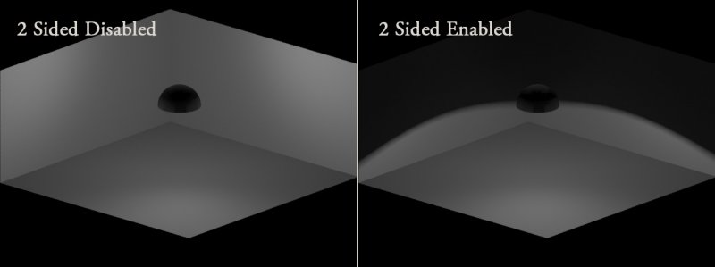

The problem is not with your light, it's with the material you have applied to the lamp shade. You need to set your lamp material to be 2 sided so that the light does not emit out through the lamp shade. The renders below were done with Mental Ray, but the same principle applies.
I just checked it was set to 2 sided but I anyway tried it with Vray2SidedMaterial as well, it's still the same. what's obvious here in this case is that the light is hidden in the render. what's the way to fix it? it seems that renderer takes it into as a hidden light so it doesnt shown it in the final image. I looked up every vray parameters in the render setup, I enabled all the options for hidden objects to be rendered. but no result !
Well, you could try using a spotlight then, instead of an area light. I'm not familiar with Vray though, so I can't really offer any further assistance, and I don't think we have any Vray experts here?
