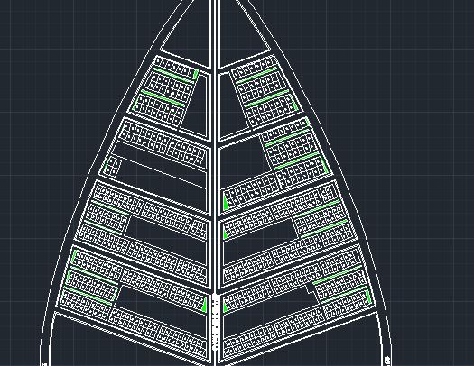

Let me show you my work so far
As you in the image, i have, so far, laid two category of housing plots one is of 600 sq.yds and the other is 400 sq.yd. And there is space left for commercial, education, social, health, welfare,recreation, and public ( government) uses. Further i have to diversify the housing provision by providing housing for lower class of population. Now either that could be accomplished by provision of plots or by the provision of apartment buildings, which would be somewhat more economical. I was wondering that maybe i should provide footprint of the buildings. For example,
So any suggestion for the layout plan of apartments?

Well, i want to provide some apartments buildings, such that i know their area coverage, floor area of the apartment (which i want to be of 240sqyd and 120sqyds), and the number of apartments the building contain.

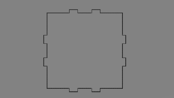

A top view of the building would suffice, like the one i've posted below, given that i know the correct dimensions and number of apartments the building is going to contain.

I thought you created at least one apartment building block. You should be able to determine its area. As far as the number of individual apartments in the building that depends on what you based your design on. The image I provided had eighteen apartments.

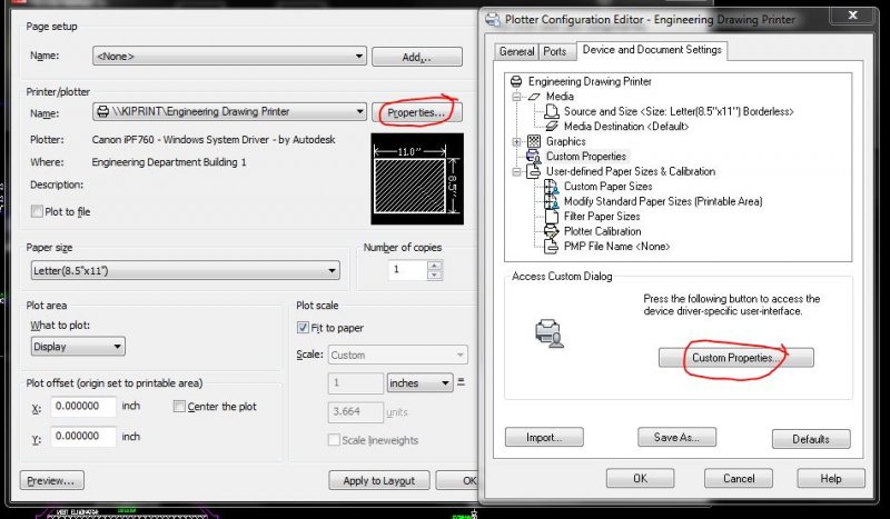

My work is finished now, thanks to everyone who contributed in this thread, though I am gonna need some quick help. I've got a bit of idea about viewports and now am able to work with them. The thing I have to submit my work by day after tomorrow anyhow. My drawing measures 3610' x 8318', I came to know the guy with plotting guy has a plotter with maximum page capacity of 3.5' x X. Where x means the kind of no limit. I want to print the file on 1" = 200' but don't see the required page size i.e. 4.62' x 2'. I am not sure about page customization. Some urgent help would be appreciated. Thanks !
I'd use a sheet size of ARCH E1 which is 30x42.
Start by looking here.
