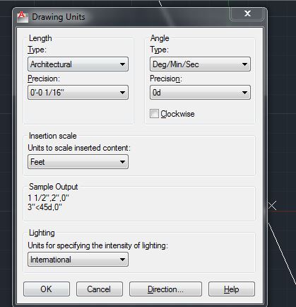

Mir Ali Posted September 12, 2013 Author Posted September 12, 2013 ReMark said: I'm not seeing a problem. and here are my units settings, i guess the problem lies here. Quote
ReMark Posted September 12, 2013 Posted September 12, 2013 Let me guess. You are seeing a number (after scaling) that looks something like 9.49E+13. Is that right? What is the overall height of your leaf? What is the width of the leaf at it's widest point? Express both dimensions in rounded off feet. I'm guessing you are going to come up with some rather large dimensions. Quote
Mir Ali Posted September 12, 2013 Author Posted September 12, 2013 ReMark said: Let me guess. You are seeing a number (after scaling) that looks something like 9.49E+13. Is that right? What is the overall height of your leaf? What is the width of the leaf at it's widest point? Express both dimensions in rounded off feet. Yes, after scaling i get this 96915372780417.42 sq. ft. Prior to scaling the height is around 12' and widest width is around 5'. Quote

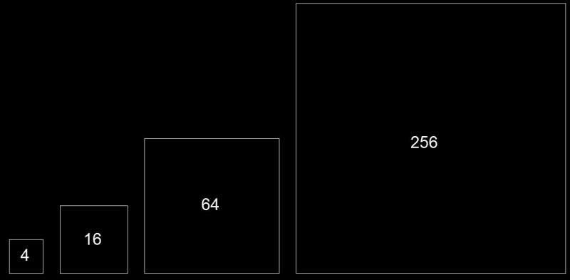

ReMark Posted September 13, 2013 Posted September 13, 2013 Maybe a graphic will help. Start with a 2x2 square with an area of 4. Scale it by 2X and we have a 4x4 square with an area of 16. Scale that by 2X and we have a 8x8 square with an area of 64. Scale that by 2X and we end up with a 16x16 square having an area of 256. While the length of the sides double the area increases by a factor of 4. Quote
Mir Ali Posted September 13, 2013 Author Posted September 13, 2013 I actually missed the square part in neophoible's post, and it finally worked. 74x= 65340000,and the square root of 882972 gave me 939 and scaling to 939 get me the exact desired area. Thank you so much your help guys. @ReMark I am from Pakistan. I am surely going to need some help when i get this thing to be plotted on paper, should i make another thread for that or this one is fine? Quote
