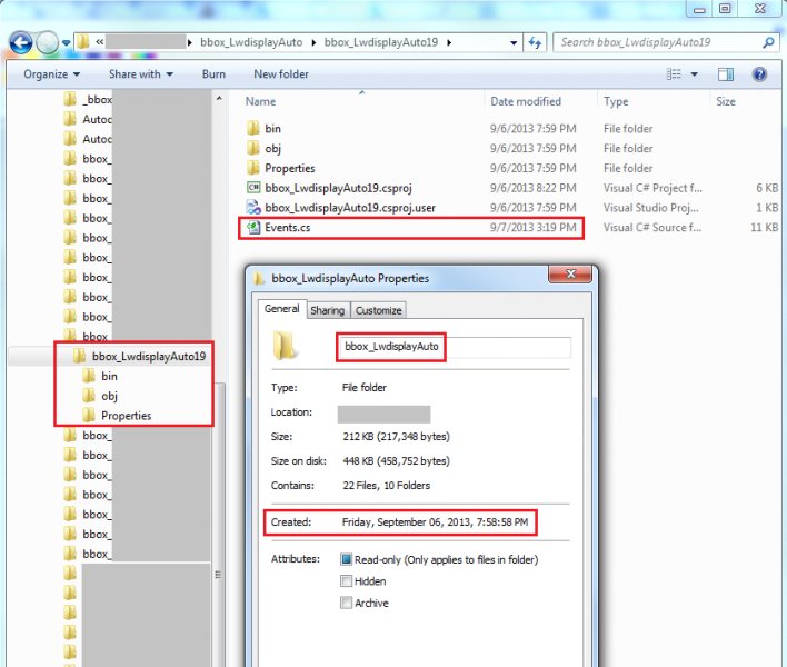

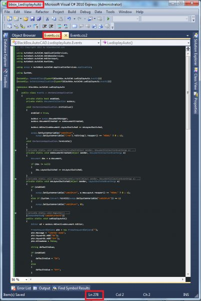

I was quite sincere, and put a great deal of thought into volunteering my time on this, despite Tannar offering to compensate me for my efforts (here and via email; I hope he doesn't mind my saying so? :unsure:)... I thought it would be a simple (not simplistic) app for portathon, which Autodesk would pay me for, and that would also allow me to offer it as a free app for others (certainly Tannar would get it for free, and well before being potentially published).
For the record... I started this LWDISPLAYAUTO project Friday night when I got home from work, before taking out Mrs. BlackBox, and continued working on the app for a bit the following afternoon (+/-275 lines of code in all) before we spent a few hours more getting some sun out by the pool, because I felt (and still feel) that this idea had merit for all the legitimate reasons described above, without which BTW Autodesk would reject my app submission:
As for your analogy, while I share the sentiment that this should be user preference, unfortunately, LWDISPLAY is a drawing (not application) saved system variable, just as PSLTSCALE, VISRETAIN, and UNITMODE are. Admittedly these have greater impact than LWDISPLAY; I'm not suggesting them to be equivalent, simply making the point that they're all stored to Drawing by Autodesk design, and should share some common level of 'handling' when making changes, IMO. It's perfectly fine if you, or others disagree.
As it happens, LWDISPLAY is part of two of the client standards to which I must adhere at work (remember, I'm a CAD Tech, not a professional developer; my example was from personal experience on a new project started this year)... And yes, these two standards also mandate the drawing be saved in their respective CELAYER specification... I'm not kidding, there's a 3rd party add-in which tells us what percentage our drawings are in compliance with their standard at save/close, which is ridiculous, IMO. They're the client so we do what we're told, because they run this same check on all submittals, and if not within a percentage tolerance, they reject our submittal (read do not pay us).
