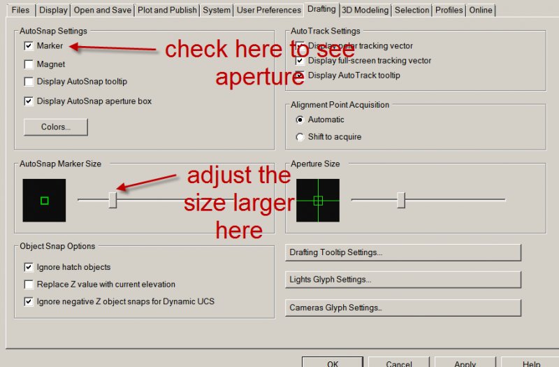

rkent Posted September 6, 2013 Posted September 6, 2013 You should set the marker to show and adjust the size of the aperture to a larger size. That should do it. Quote

dwynath Posted September 6, 2013 Author Posted September 6, 2013 You should set the marker to show and adjust the size of the aperture to a larger size. That should do it. The settings were migrated over from AutoCAD 2011. The marker shows, aperture is fairly large, osnap tracking is on. I have never had this problem before the 2012 version. The only thing I can think of is there is too many osnap modes on (only the node, and parallel modes are turned off). Quote
