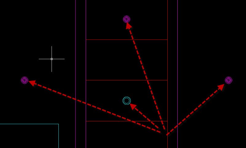

We have received a few drawings from another contractor and they exploded the whole drawing before sending it to us (thanks).
There are a bunch of circles with inner concentric circles that are making the test plots too dark for those symbols.
There are hundreds of these exploded symbols in a single drawing. And the drafters would like to delete the inner circles.
I have shown the guys QSELECT and yet that seems to be too difficult for them (too many options for them). And I have done a quick google search and haven't found any existing routines.
Does anyone have a routine that will select all circles of a user specific radius or diameter?

This should select circles with Diameter value 100.
(sssetfirst nil (ssget "_X" (list '(0 . "CIRCLE") (cons 40 100.))))
Filter out the layer name also just in case you have other circles that you don't want to delete.

Thank you both for your replies.
jdiala - this will work great for their needs.
Much appreciated
~Greg

Here's another option:
(defun c:cdel ( / e i s )

This is how I would go for it .

How about this. It only delete circle/s inside of a circle as long as they have a common center point.

Here is another possible way to write it, to avoid repeated selection set retrieval:
