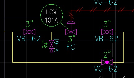

I am looking for a match property program that will work with block text attributes
I am hoping that someone will offer me tips in how to accomplish this
Currently I think it would require
exploding the block
get dxf codes from source text
apply them and entmod the text-to-be-changed
wblock back together
But am not sure if this is the most efficient way to accomplish such a task.
So looking for some comments, suggestions.
I'll attach a picture to explain what I mean , often the attributes in our blocks are on separate layers and colors when they in fact should not be!
If there is an existing match property lisp routine that will work for blocks or nested blocks/xrefs, I would love to get a copy.
Oh once again Lee has made this, alright! :D
