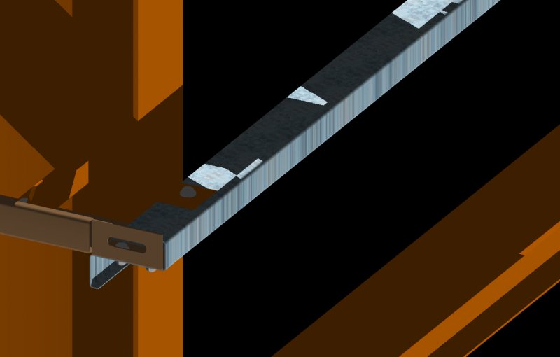

Hey guys,
Just doing a little rendering for a presentation.
Using Navisworks Simulate 2013 and have noticed that when I try to apply a material texture to an element... it doesn't 'wrap' around the edged of the element, rather it stretches down the sides (see image below).
Just wondering if anyone knows how to get this to behave in a more expected manner. Most of my rendering experience is with Navisworks Jetstream v5 and I never had this issue with that version.
Look forward to hearing back.
Thanks a lot for any help.
  • 4 weeks later...
Still having this same issue, it appears the textures are properly applied (flat to) to only faces in the XY plane (XY in the DWG). All faces not in this plane still have the texture applied, but it is not true to that face.
Anyone else seeing this issue with their setup?
-----EDIT-----
Found a solution.. Right click on an element>Presenter>Texture Space>...toggle.
Solved it for me.
