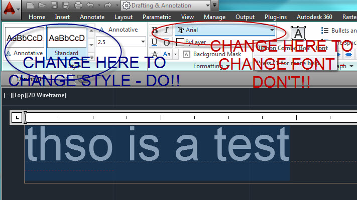

Sengna Posted September 2, 2013 Posted September 2, 2013 I was working on one of the existing cad drawing, i came across this problem. I tried to match my Mtext with the existing text style, after M.P (match prop) everything look the same except the fonts style would not match, why is that? Does it have to be on the same layer? Thanks Quote
dbroada Posted September 2, 2013 Posted September 2, 2013 a pet hate of mine is how some people change the FONT inside MTEXT without changing the style. I would guess this is your problem here. The easiest/quickest way to procede is to explode the MTEXT back to DTEXT but if you must have MTEXT there are some LISP files available on this site. There should be several as it is a common problem. Quote

RobDraw Posted September 2, 2013 Posted September 2, 2013 There are a few LISPs out there that will return any overrides to the style and layer settings. I use one called STPMText quite frequently. Quote
Sengna Posted September 2, 2013 Author Posted September 2, 2013 So to sum it up - DON'T change the font, DO change the style! I am little confuse, Are they not the same b/w font style and text style? Ex: Standard, Roman, simplex…., to change the text style I just go click on the text and go to ObJ Property then select TEXT STYLE from the drop down menu or how do you guys do it different? Quote

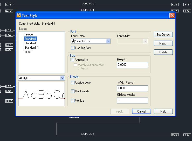

Tiger Posted September 3, 2013 Posted September 3, 2013 The Style and Font are often called the same, which is why it is easy to make the mistake of changing the Font instead of the Style. I have tried to make a picture to illustrate, ignore that I can't spell 'this', it's too early for spelling. Quote
dbroada Posted September 3, 2013 Posted September 3, 2013 Just to add to Tiger's post, you should set up individual text styles (using the STYLE command) each with their own font. The same font can be used several times - for instance with a different width - but the style name is unique. Hint - DO NOT change the height from 0 if you don't understand the consequences. A text height of 0 allows you to set the height later. Quote
