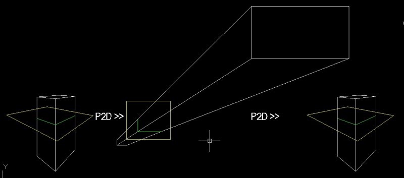

Hi, this lisp is working in 2D only: it generate a perspective view from a selected 2D plan or elevation.
1. Command: P2D
2. Select the source frame (trapezoid polyline) of the plan or elevation
3. Select drawing objects in that source plan or elevation
4. Select destination frame >>> a new perspective drawing would be draw arcordingly (see image and example drawing)
5. Repeat step 4 until you select none
It is working only with straight lines, straight polylines and points. Pretty useful when you want to take a leap up from your 2D, for but donot have time to create a 3D model.
New version on Apps Exchange Store, extrusion enabled

Sean, you can do it much better than me. Mine doesnot work with curves, hatches nor texts: too complicated for me coding those with Lisp. The only one thing better in my routine is: it is handy, all in one command, and you can start next command by picking on the new created plines of current command.

this feature is great, need help coz when i select the destination frame it turned 180 degress instead of 90 deg. so its coming horizontal instead of vertical, kindly someone teach me to reset it to previous.
thanks!
Just click R to rotate it all around. And make sure you have installed the new version avaiable on the Autodesk App Exchange Store.

just installed the new version and its working great!!!
Thanks a lot for the help!
