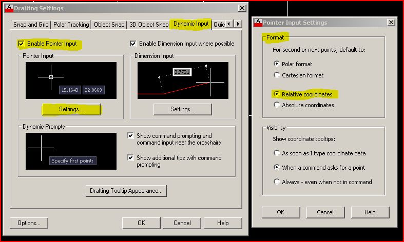

Dadgad Posted September 1, 2013 Posted September 1, 2013 (edited) Welcome to CADTutor. It sounds like you had DYNAMIC INPUT turned on last night, and it is now turned off. F12 will cycle Dynamic Input on or off. You can also turn it on and off at the bottom of your screen on your status bar. If you are not using Dynamic Input and want to create a rectangle, the coordinates of which are RELATIVE to the base point then enter @ at the commandline, before inputting the x and y distances. The default behavior, I believe, will treat your coordinate input as ABSOLUTE coordinates. You can also set your personal drafting preference for dynamic input, to either Relative or Absolute, as shown in the image. In order to access the dialog box, type OSNAP at the commandline, and enter. Edited September 1, 2013 by Dadgad Quote
JD Mather Posted September 1, 2013 Posted September 1, 2013 Relative @ Absolute # Limits off Regen Zoom all Quote
