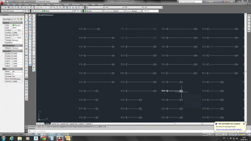

I've got a problem with some of my text's in Autocad. From the screenshot you can see some different texts, theese are copied by their content and pasted manually.
Now, ive got to change the content of theese, and i dont want to do that 1 by 1. Is there a way i could edit for ex. all my YV-E-------------1H at the same time?
Would appreciate some help on this :)

Ahhh, simply forgot it as i always do :P Thanks by the way :)

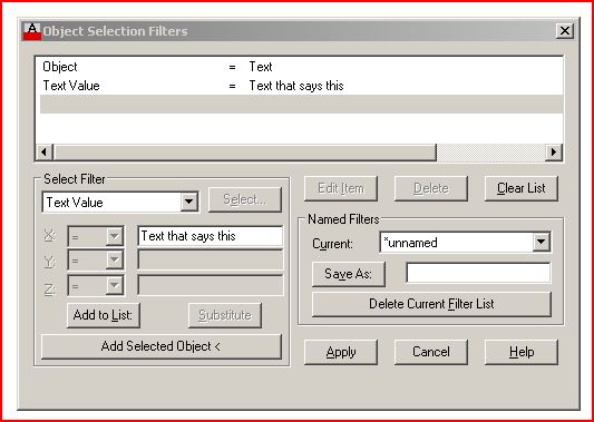

While im at it, is there some way i can mark all of the similar text too? If i want to move them all a bit to the left?

You could select all the occurrences of a particular text string by using the
FILTER command, as shown in the image.
If after using it, you lose the selection set,
just start the Move command and use P for previous selection set.
Should you want to create filters for reuse another time,
as setting them up takes more time than using them,
use the SAVE AS option.
Filter is a very useful command.

Thanks dadgad, I learned something here. I didnt' know you could save your selection set. :notworthy:
In this case, as Dadgad pointed out, you are saving the filter list you set up, so that you can use the same filter list again sometime. AutoCAD automatically saves the Previous selection set. Usually, it is even preserved through Undo.
Wow this is pretty neat. Thanks for the info dadgad!
Those unfamiliar with the FILTER command will no doubt be blown away by all of the different
available selectable object types, in the SELECT FILTER and the search parameters which can be applied to help define
a particularly difficult selection set. :)
