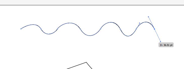

f700es Posted August 29, 2013 Posted August 29, 2013 Probably drawn with Illustrators Pen tool. Newer versions of Acad handle splines better. In Illustrator CS5 Quote

Dana W Posted August 29, 2013 Author Posted August 29, 2013 Probably drawn with Illustrators Pen tool.Newer versions of Acad handle splines better. In Illustrator CS5 [ATTACH=CONFIG]43715[/ATTACH] Quite likely. It did look decidedly hand drawn. Quote
