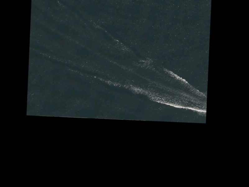

Tiger Posted August 29, 2013 Posted August 29, 2013 (edited) Hi, I have a problem with 3DS Max, which is kinda hard becuase I know next to nothing about 3DS Max. In the attached image (and file) you can see lines in the image that wasn't there in the actual image. My guess after a bit of looking around is that Max creates meshes from this image (it's exported from Infraworks) in sizes that it decides on its own, and the lines in the image is somehow the edges of the meshes. I have assumed that it's the old problem of two objects occuping the same Z-level and that is why the edges are showing. Now, the question is, can the lines be removed? Can the image on top of the mesh somehow be lifted a fraction of an inch so that the mesh edges don't show? I think I got the file down to .. (edit: now 2011), let me know if anyone wants to look at it in an older format. Thanks for any pointers! strangelines.max Edited August 29, 2013 by Tiger changed file format Quote

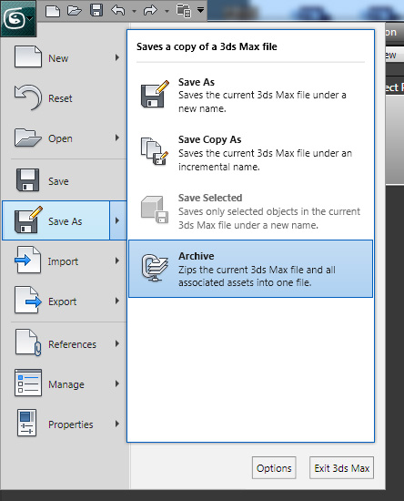

Cad64 Posted August 29, 2013 Posted August 29, 2013 Strange that you don't see the image, I'll see if I need to do a bind or something. Images are not saved with the file. They are externally referenced in, just like images in Autocad. Use the "Archive" option under the "SaveAs" category to grab all the files associated with your Max file and stick them all into a .zip file. Have fun in Amsterdam. Quote

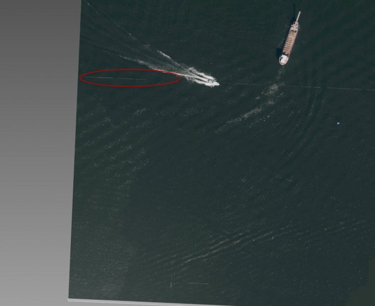

Cad64 Posted September 3, 2013 Posted September 3, 2013 I moved one of the image planes away from the others and rendered it by itself. As you can see in the image below, the bad edge still shows up. I thought there must be a problem with the image edge, so I downloaded and installed a DDS image converter for Photoshop and opened the image to check it out. The image appears to be fine though. I can't see any problem with the edge at all. So I don't know why the lines are showing up in the renderings? If you want to look at the images in Phtoshop yourself, you can download the converter here: https://developer.nvidia.com/nvidia-texture-tools-adobe-photoshop Maybe you can convert all the images and then stitch them together, into one big image, and then apply that single image to a plane in Studio Max? Either that or just touch up the images, after rendering, to remove the lines. Quote

Tiger Posted September 5, 2013 Author Posted September 5, 2013 This just gets weirder and weirder. I looked at the video you linked, and opened Viewport Canvas, Highlighted one of the meshes with the strange edge, and clicked the paint brush to start painting - and the image on the mesh changed! And if I look at the edge (where the strange line was) I can see that this is the image that I see the edge of! But why on earth would there be double images?? That souns like there is something wrong with the export from Infraworks though ... something happens there in the switch. Quote
