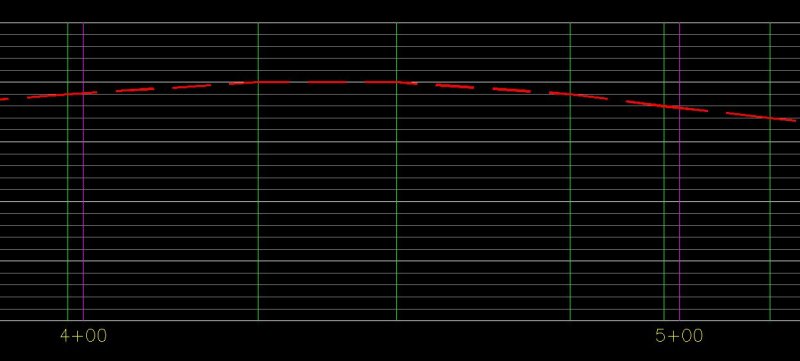

ReMark Posted October 25, 2013 Posted October 25, 2013 A closeup of one portion of the centerline profile. The green vertical lines are my temporary offsets for distances between contours as defined by the centerline of the road. The light gray horizontal lines are set at 2 foot intervals while the white horizontal lines are set at 10 foot intervals. Quote

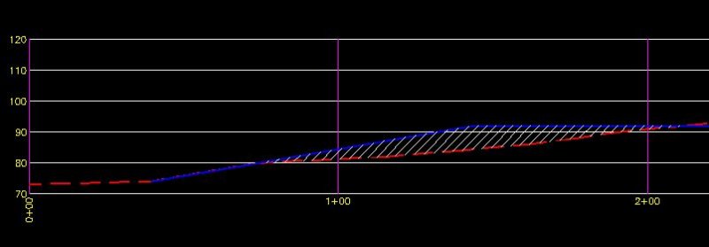

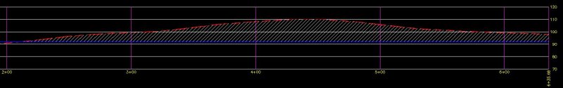

ReMark Posted October 25, 2013 Posted October 25, 2013 I believe this is what the proposed centerline profile would look like superimposed over the existing. I am referring to the dark blue line. Quote
ReMark Posted October 25, 2013 Posted October 25, 2013 The area that needs to be filled to elevation 92 (shown hatched). The area that needs to be cut to elevation 92 (shown hatched). Quote
