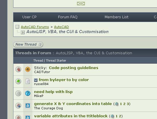

Go to the most relevant section of the Forum, in this case AutoLISP, VBA, the CUI & Customisation and click on the New Thread button.
