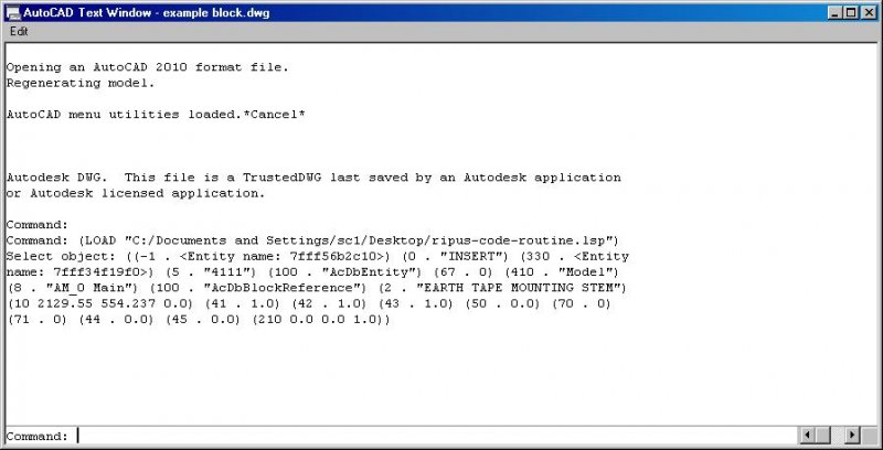

I have a cad drawing which contains 1000's of blocks, each with its own part reference within. As we use autodesk Vault and cad's design centre in tandem both the block name and partref description need to match. At present many block do not.
What I am investigationg a a lisp type routine which will automatically rename all blocks in a drawing with its part reference description.
As I am a novice with lisp I would like the forums help with this.

It´s easy to rename blocks but we need to know where to find the part reference.
Is the part reference put in extended data or is it just inside an attribute?
If you don´t know the answer, copy paste this. Select a block and post the outcome here.
(entget (car (entsel)) '("*"))

ripus - I have ran your code and the following is quoted in the command line:
I have attached an example drawing Link: https://dl.dropboxusercontent.com/u/4770031/example%20block.dwg
This is a standard block which contains an AMPARTREF object (specific to autocad mechanical). This holds the make / model No' etc of the part.
What I would like is a bulk / batch routine which automatically renames all blocks within a drawing with its part reference description housed within each block.
