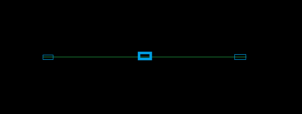

I have a polyline, and this has the same vertex overlapping, how to identify the vertex overlapping and zooming in it?
Using lisp.
So you have a polyline with a vertex, and you want to zoom in on this vertex?
Do you mean that the polyline has two or more vertices located at the same position?
Zooming a duplicate vertex in a polyline seems not appropriate. A better approach maybe is to encircle the duplicate vertices.
It is as if the operator autocad, to make a polyline , create a new vertex on the other another vertex or drag one over the other.
Do I just need to zoom in on this vertex.
Lee, That's it. It is as if a vertex had another about it.
