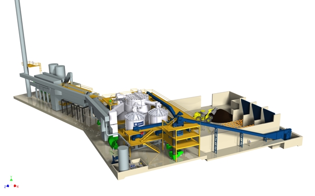

At least I can post a pic now of the model I've been working on that has been bringing Inventor to it's knees. A lot of work to do still, but it's getting there.
Obviously we're are looking at an overview. How detailed is it exactly and what kind of file size are you dealing with? Did you construct it in sections?
Total current file size (if pack 'n go'd) is 1.2 GB. Total assembly consists of 105 parts and 142 occurences. All the parts are simplified shrinkwraps (certain components, nuts/bolts, not visible parts, etc. removed) which have their links broken, grounded in place, and all constraints deleted. There are several levels of detail created so I can work on certain areas easier when not needing to see the entire assembly.

What's the building's purpose? Is it some sort of batching plant? Do you guys do chemical plant design?
The actual assembly file is only 357 KB, much like an Xref drawing file. Yes, they are separate files, brought into one file to make one assembly. Think of it like having a general arrangement drawing of a multi-conveyor system, but each conveyor in that drawing is an individual xref.
It's for a wood waste to energy plant, you can see more info here http://www.nexterra.ca/
