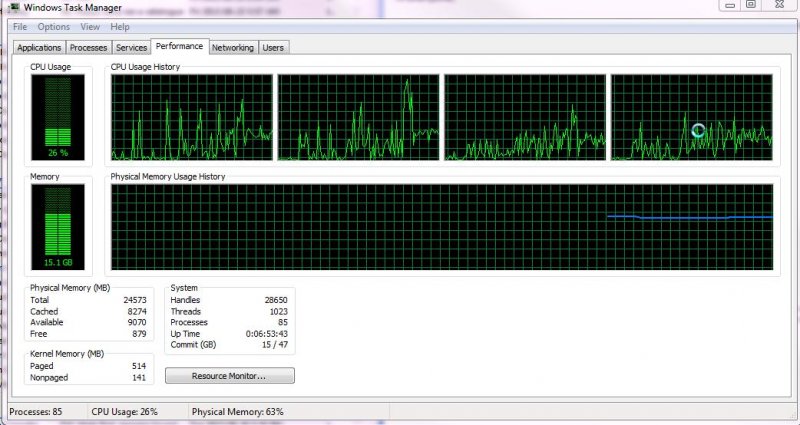

Enigma Posted August 23, 2013 Posted August 23, 2013 (edited) Our company will be upgrading the engineering departments workstations in the near future, and I'm looking for some real world suggestions vs. Autodesks recommended specs. My current station, which is one of the better ones in our group, is as follows: Dell Precision T3500 Windows 7 Professional 64 bit Intel Xeon 4 core W3565 3.2GHZ 24 GB RAM Nvidia Quadro 4000 I want to suggest something to our IT/purchasing dept that will let me work on the large plant scale assemblies in Inventor 2013 pro so I don't spend half my day watching a circle spin. I think my current bottle neck is the video card, as I can spin my assembly (which is only 91 unique parts and 203 occurences of a large energy plant) around and zoom a few times before it chokes and regenerates awhile with some of the parts visible until it fully regens. This can take several minutes every few minutes, very frustrating. According to task manager, my PC is using around 45% or so CPU usage and 65% RAm while I'm flying around. Any suggestions? We don't have a NASA budget as much as I'd like one. edit: I'll also add I've followed the "guidelines" as much as possible regarding large scale assemblies to reduce the lag. The parts in it are simplified (while still keeping required detail) shrinkwraps of the various components (conveyors etc), everything is grounded and then the constraints deleted, any colour overrides removed, etc etc. All of our work is run off of a network. I have copied this project onto my local drive to see if that makes a difference, and it did not. Local hard drive is about 50% full, 141 GB free space. I'll keep updating this as I think of things and hope for some insightfull replies. As this current machine is a multicore, I do have a few programs running at the same time, which shouldn't affect Inventors performace as it only uses multiple cores in the drawing state. I usually have running MS Outlook, web browser (Chrome or Firefox), Adept Synergis 2013(Our networked document management system), and at times during the day Windows Explorer folders, MS Excel/word, photo viewer, and perhaps a few personal programs like Uconeer. I also run 2 24" Samsung SyncMaster monitors. From everything I've read off the internet, my current system meets or exceeds the highest specifications for Inventor, but "I need more power captain". We have 3 other very experienced Inventor users here who share my level of frustration with the hardware performance when we work on these "large" assemblies. And by large they do not have a massive part count as mentioned earlier, but lots of surfaces, lines, etc etc etc. And I have just now realized this is buried in the Autocad forums Edited August 26, 2013 by Enigma updated info Quote

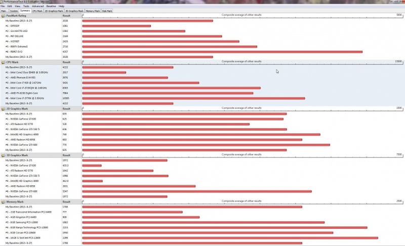

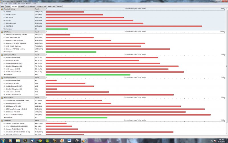

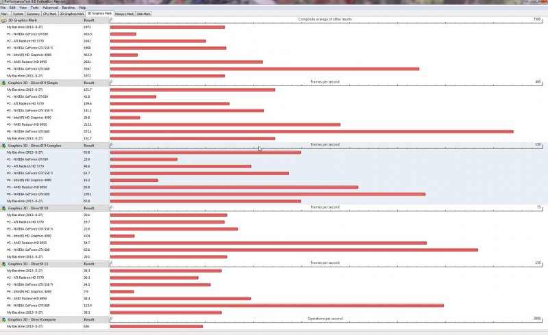

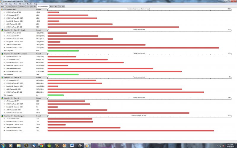

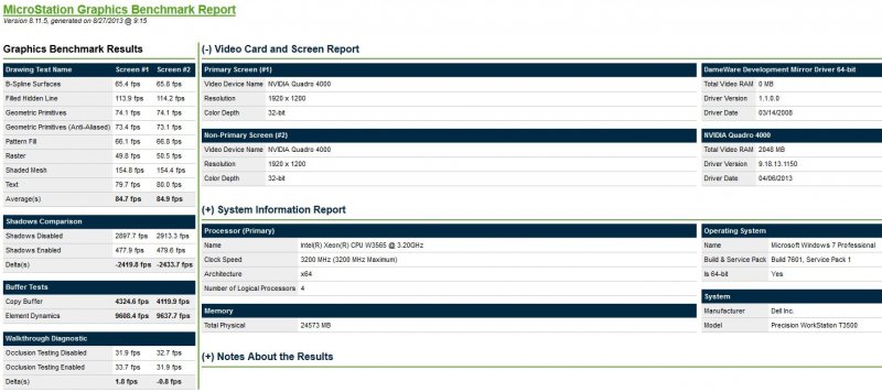

Enigma Posted August 27, 2013 Author Posted August 27, 2013 (edited) Since I'm doing some work from home at the moment (different job though, can't bring my day stuff with me), I thought I'd run the Bentley performance test that the Cad Digest article mentioned on my home machine (which has a Windows experience rating of 4.9, specs in the drop down under computer details in my sig) and compare it tomorrow to my work machine . And the PerformanceTest on my home machine rated at 608.7 From the 3D grahpics mark, if one was shopping for a new card the GTX 680 seems to shine. Edited August 27, 2013 by Enigma added pretty pictures Quote

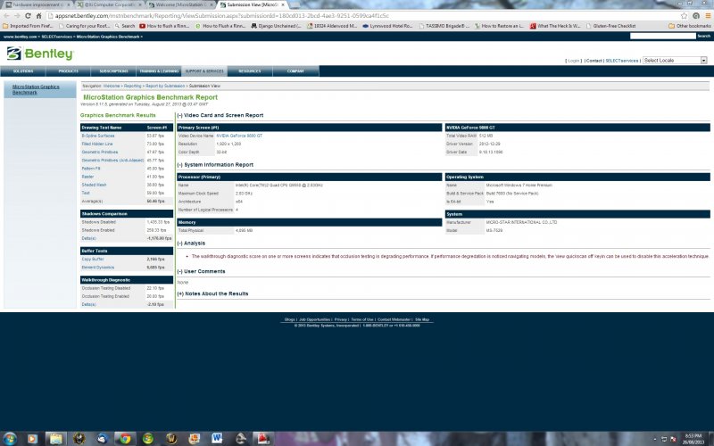

Enigma Posted August 27, 2013 Author Posted August 27, 2013 And now my work stations results, which seem pretty good. Bentley results and Passmark result is 2028, pretty impressive really. And while all of this was somewhat fun, still doesn't really help Quote

Enigma Posted August 27, 2013 Author Posted August 27, 2013 (edited) Do you have to have microstation to use that benchmark tool? No. It's just a quick download, scans your hardware, and runs some funky visual tests, then spits out a result. You can then choose to upload and share your results. Edited August 27, 2013 by Enigma Quote

f700es Posted August 28, 2013 Posted August 28, 2013 Wow, so for AutoCAD one comes out better with a high end consumer card as the performance is on par or better than a professional card but at a substantial lower cost. The Quadro K4000 has a street price of $760 at newegg (link) and the GTX 680 is $390 also at newegg (link). Interesting indeed. Quote
