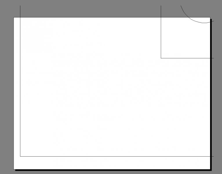

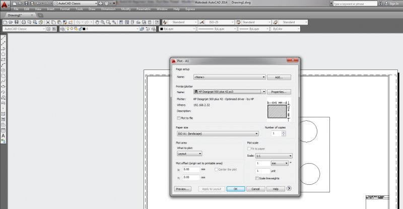

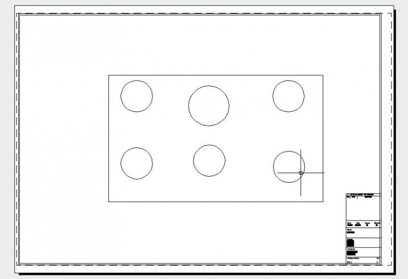

sparkyuk Posted August 22, 2013 Share Posted August 22, 2013 We have just installed Auto CAD 2014 and opened an existing drawing made in 2010 version it opened fine went to print it and something weird happened, the plot window seems to be corrupt, I did try the same dwg saved back and then reopened in 2010 and it prints fine so its not the drawing. So I then opened a new A1 drawing and did a simple drawing direct in 2014 and tried to print as before and it did the same thing (see photos), I also did try printing it and it printed the same a the plot preview below. So is it 2014 to blame or is it a setting that needs sorting please ? Quote Link to comment Share on other sites More sharing options...
mikekmx Posted August 22, 2013 Share Posted August 22, 2013 settings. in 'page setup manager' when you right-click the PS tab you are going to plot. especially check page size and orientation throughout loads of settings Have a play....it may take a while :-) ^^^ as always, i may be totally wrong. Quote Link to comment Share on other sites More sharing options...

RobDraw Posted August 22, 2013 Share Posted August 22, 2013 This really looks like the layout size in the drawing is larger than the page size for the plotter. Quote Link to comment Share on other sites More sharing options...
sparkyuk Posted August 22, 2013 Author Share Posted August 22, 2013 Made it worse how? Its made the drawing zoom out even more Rob yes it is whats happened but there is no reason for it so i am still unable to find a solution to this problem. Even if i say "print to fit" and not worry about scale the drawing still over hangs the paper size ? Quote Link to comment Share on other sites More sharing options...
RobDraw Posted August 22, 2013 Share Posted August 22, 2013 Could it be units are different in layout than they are in plotter? Quote Link to comment Share on other sites More sharing options...
sparkyuk Posted August 22, 2013 Author Share Posted August 22, 2013 You thinking metric on drawing and imperial on plotter ? I am off out now but will check tomorrow when back in office Quote Link to comment Share on other sites More sharing options...
RobDraw Posted August 22, 2013 Share Posted August 22, 2013 It looks like the ratio could be 2.54:1. Quote Link to comment Share on other sites More sharing options...
mikekmx Posted August 22, 2013 Share Posted August 22, 2013 Hello Mikekmx been there done that and it looks fine from the page setup page but not when plotting for real m8 ? Hello Remark I haver checked and i am not seeing "Center the Plot"? in any of the setting where do I need to look please ? go into plotter properties Quote Link to comment Share on other sites More sharing options...
