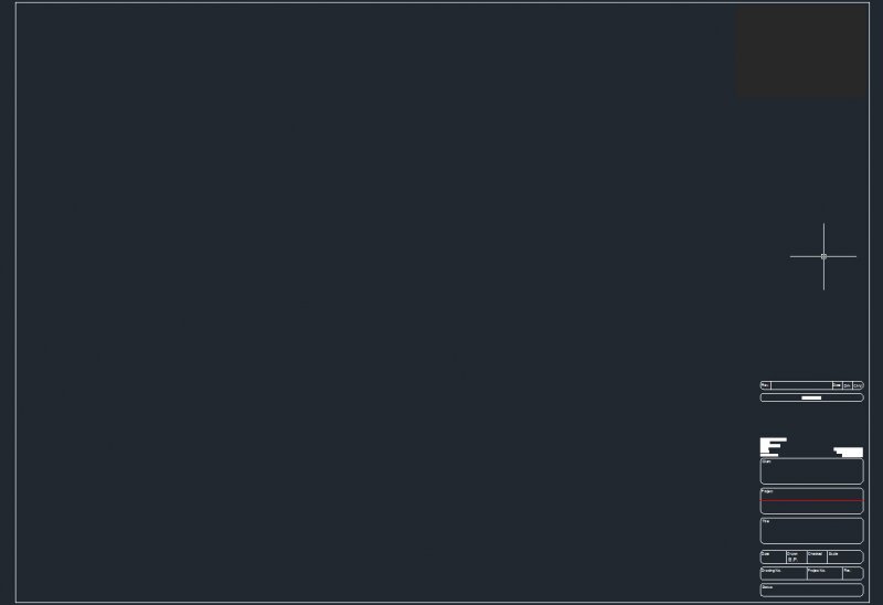

What’s the typical width indicated by the red line shown in the drawing below on a scaled A1 title block?
100mm or 50mm

I don't have any outside companies A1 title blocks to look at.
We use 100 mm, actually 200 mm because our title block is split in 2 parts laid out side by side, and it is the same size for all paper sizes A0 down to A4 (A4 portrait is slightly smaller because of the boundary)
There is no definitive standard for the size of title block on a drawing.
It would be more personal preference and what information has to be conveyed with the discipline involved.
A1 - Between 90-100mm
Like Steven says, it's best to try and keep the same size title block for all drawing sizes, although A4's titleblock are usually always a different size and/or the orientation can be changed around to portrait.

I know generally most companies have a width of 100mm for A0 whereas I made a version a few years ago which had a width of 155mm. While this may look ok sometimes it was hard to fit a building inside! A building scaled at 1:100 would crash over into the title block details.
By reducing this width to 100mm it wasn’t a problem anymore and also I guess it looked more professional.
I thought maybe an A1 title block would have a 50mm width being that it’s half the size of A0 to keep everything in proportion.
I was just throwing it out there.
There is no typical width. You can make it as bid or as small as you like.
