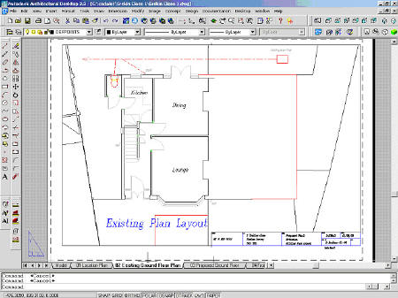

sunsan Posted August 19, 2013 Author Posted August 19, 2013 I was trying to upload a file to let you see the problem I have with the layout. But i'm having some problems... It is like the model space, an unlimited space... I tried with the page setup manager but nothing happens! Thank you for the help. I will learn the new method Quote
ReMark Posted August 19, 2013 Posted August 19, 2013 Model space has no real limits and if you are trying to set one up arbitrarily (using the LIMITS command) I would recommend against it as that technique is no longer of any real concern to most CAD users. Do NOT draw "to scale" in model space. Drawing everything full size. What is the size of the structure you are drawing? Quote
sunsan Posted August 19, 2013 Author Posted August 19, 2013 I'm not trying to to scale in model space... This is my layout space.. I just wanna have the layout limited, like this one: Quote
ReMark Posted August 19, 2013 Posted August 19, 2013 It looks like you are showing only a portion of the building. What scale are you using at the moment for your viewport? Quote
sunsan Posted August 19, 2013 Author Posted August 19, 2013 Yes, I only have to show part of the building. Honestly? I not using any scale! Im just adjusting by hand as I think is easy to see.... Quote
