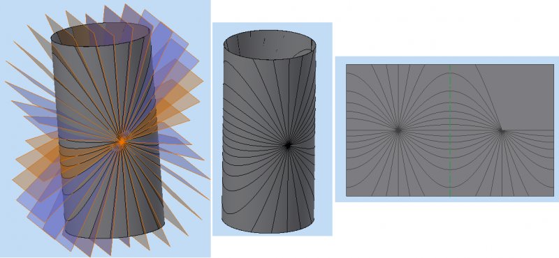

WDW4 Posted August 19, 2013 Posted August 19, 2013 I need to plot specific lines on the face of a cylinder, then "peel" the face of that cylinder off to be a flat plane, retaining the plotted lines. I have a few ideas of how to do this, but neither the expertise to do it nor to know if it is the best way. The lines need to be thus: Imagine a vertical cylinder. A horizontal plane passes through the exact center of the cylinder, and extends far past the faces. When the cylinder is vertical, the intersection of the plane to the face of the curved face of the cylinder forms an exact circle around the middle of the cylinder. This line is "0 degrees", because it is the line formed around the cylinder when it is rotated "sideways" (top moving right and down, bottom moving left and up) 0 degrees. Now, I need lines at 5, 10, 15...and so on to...90 degrees. The 90 degree line would form a line straight up one side of the cylinder, across the top, down the other side, and across the bottom. Once I have these lines drawn, I need to be able to be able to "peel" the curved face of the cylinder until it is a flat rectangle with the drawn lines on it. I have only used google sketchup, mainly for woodworking and carpentry. 1. What free or paid programs could I use to do this? 2. What functions could I use to do it? 3. Bonus if I could either use the same program to modify the resultant design with some text and graphics, or use the resultant file type in some graphic design software. Thank you! Quote

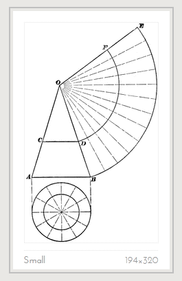

ReMark Posted August 19, 2013 Posted August 19, 2013 That was not what I was looking for. Would you recognize the development (or pattern) of a cone or a pyramid for example? Quote
WDW4 Posted August 19, 2013 Author Posted August 19, 2013 ReMark said: That was not what I was looking for. Do you know what a development is? I'm afraid not ReMark, but I'm eager to learn if it will further this project. Quote
ReMark Posted August 19, 2013 Posted August 19, 2013 A development of a cone. Source: http://etc.usf.edu/clipart Development of three types of cylinders. http://draftingmanuals.tpub.com/14040/css/14040_135.htm Quote
WDW4 Posted August 19, 2013 Author Posted August 19, 2013 Is this method designed for use in AutoCAD? I can use this method with pen/paper but I'm looking for an easier way and a more precise finished product. Quote

JD Mather Posted August 19, 2013 Posted August 19, 2013 About 5 minutes of work in Autodesk Inventor (I missed a couple of splits). You didn't indicate where you want the Rip in the cylinder or the diameter and height of the cylinder. (because Inventor is parametric - these parameters are easily entered after the fact and the part will update) Students can download Inventor for free from http://www.autodesk.com/edcommunity Quote
WDW4 Posted August 19, 2013 Author Posted August 19, 2013 Wow, thanks JD Mather! That looks very close to what I need. I think I'll download Inventor and give it a shot. Quote

JD Mather Posted August 19, 2013 Posted August 19, 2013 I always consider my first attempt just a trial to understand the problem. (this attempt as at 10° increments) If I were to do it again I would do 1/4 of the part and then a couple of mirrors to reduce the amount of work. If you get Inventor - post back (with your initial attempt) for step-by-step instructions. Quote
