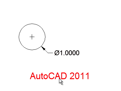

Mase123y Posted August 16, 2013 Posted August 16, 2013 When you make a diameter or radius dimension it always has this static extension line shown in red when you move the dimension far enough away. I can not seem to extend this extension line at all it is always the same length no matter what variable I change. Does anyone know how to lengthen this extension line? Quote

nestly Posted August 16, 2013 Posted August 16, 2013 (edited) The default landing length is the same size as the arrowhead. There is no easy way control them independently that I'm aware of. However, the landing was easily editable in 2011, but apparently they changed the priority of the options for 2012 and newer. The function is AIDIMTEXTMOVE which still exists in 2012. You can type that command at the command line and use "1", to move text (and landing length) or edit the CUI so that option is always available via the right click menu for dimensions. (Dimension, Text, Move with Leader) Edited August 16, 2013 by nestly mis-spelled command name Quote

Mase123y Posted August 16, 2013 Author Posted August 16, 2013 Well I can add the command "Dimension, Text, Move with Leader" to the right click menu and that does seem to work for just extending the landing although it does change the way the arrows are situated inside the radii/circle. Quote
nestly Posted August 16, 2013 Posted August 16, 2013 Well I can add the command "Dimension, Text, Move with Leader" to the right click menu and that does seem to work for just extending the landing. So is that an acceptable option, or was your intention to change the default landing length for Diameter dimensions? (because I just thought of a possible way to do that too using a custom arrowhead and a child dimension style) Quote

nestly Posted August 16, 2013 Posted August 16, 2013 ....although it does change the way the arrows are situated inside the radii/circle. Can you screencap that as well if the change is objectionable? You should be able to "force" the appearance either through a global dimstyle change, or a radius/diameter dimstyle override (child dimstyle) Quote
Mase123y Posted August 16, 2013 Author Posted August 16, 2013 Well this has to do with the Fit, I think, the arrows are no longer inside the circle. Forcing the dimension line just puts the arrows outside the circle. Quote

nestly Posted August 16, 2013 Posted August 16, 2013 Well this has to do with the Fit, I think, the arrows are no longer inside the circle. Forcing the dimension line just puts the arrows outside the circle. You may not be able to force the arrows inside if the circle is too large, but if you want both arrows, use "Draw dim line between ext lines" on the "Fit" fit tab. Create a child dimstyle if necessary. demo --> ... by the way the command is AIDIMTEXTMOVE. I think you left an I out between D and M... ...fixed Quote
