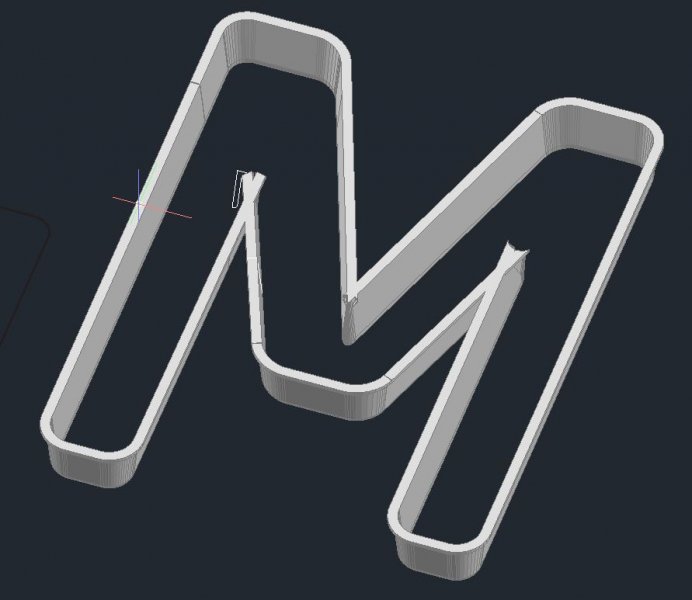

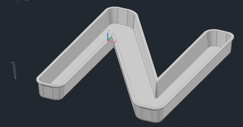

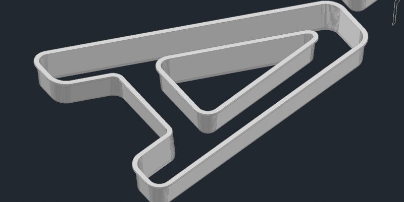

robochrish Posted August 14, 2013 Posted August 14, 2013 Hi guys, This is my first post so I am sorry if it is in the wrong area or anything. I have a project at the moment with a really short deadline and I am currently running in to problems. I need to create a series of "trays" that are in the shape of letters. I am having some success with certain letters, but zero success with others. I am creating these letters using a curve brought in from illustrator, and sweeping the profile that I want to use around the curve to create the outside. I am then using presspull to create the base of the tray. However, sometimes the sweep command will simply say "unable to sweep 1 selected object" with no explanation as to why. Sometimes I will get the shape that I want, but it is facing the wrong way, and I cannot fix it. Other times it will simply stall and then delete both the curve and the profile. What am I doing wrong? How do you suggest I go about it? Sorry If I am not making sense, but here are some images to help show you what I am talking about. I really appreciate any help I can get, Thanks Quote

nestly Posted August 15, 2013 Posted August 15, 2013 However, sometimes the sweep command will simply say "unable to sweep 1 selected object" with no explanation as to why. Are you certain it doesn't also say something about a self intersecting curve? Based on similar recent topics, my guess is the "curve" is either a closed spline or closed polyline that folds back on itself. If you can PRESSPULL the base, then you can EXPLODE the resulting solid into Regions, which you can EXPLODE again to get a new spline or pline to use as a path to SWEEP your profile. Quote
lamensterms Posted August 15, 2013 Posted August 15, 2013 My suggestion would be to make sure your SWEEP paths are clean and logical (they don't double back on themselves, no excess nodes/vertices, etc). With my experience importing from Illustrator... it is mostly best to recreate the imported lines when in AutoCAD. Another suggestions is to break up the SWEEP path into smaller polylines, then SWEEP each smaller segment, and then UNION them together. Using this method would allow you to achieve more focussed trial and error - which might help you find what is wrong with the SWEEP paths. Good luck. Quote

JD Mather Posted August 15, 2013 Posted August 15, 2013 I.... a really short deadline and I am currently running in to problems. I am creating these letters using a curve brought in from illustrator, .... ....here are some images to help show you what I am talking about. What am I doing wrong? Using a graphics art program for engineering design. Graphic artists communicate with images, 3D designers communicate with 3D models - attach your dwg file here. I recommend learning how to use AutoCAD to speed things up. You should have only lines and arcs (look at your radii). Quote
ReMark Posted August 15, 2013 Posted August 15, 2013 I'm assuming the letters in your images above meet your criteria so what letters gave you problems and can you post an image of one such letter? Quote
robochrish Posted August 15, 2013 Author Posted August 15, 2013 Thank you for the responses guys. I have now solved the issue for these specific letters. I solved the problem by setting the polyline to 0 instead of 1 when using PEDIT after exploding the curve. @lamensterms What would you suggest is the best way to create the curve within Autocad? I find it a little cumbersome since I am used to things like the pen tool, instead of the arc tool. @nestly No, the curve at no point mentioned self intersecting. @ReMark For the images above, the N was correct but the D and A were not. @JD Mather I apologize if I seem rather new to this but I am, hence me asking for help. I am actually a 3D artist who normally deals with software such as Maya or 3ds Max, so this is a little different for me. Thank you guys Quote

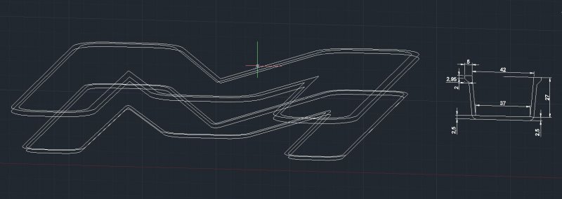

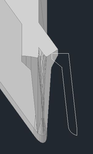

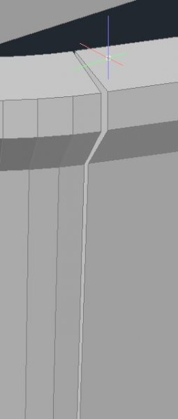

robochrish Posted August 17, 2013 Author Posted August 17, 2013 (edited) Hi guys, It appears that my problems are not solved after all. I am getting really messy corners at certain intersections. I have had this with some of the other letters, but they have been easier to clean as they have a clear corner, however this time the edges seem to cut straight through each other. I also have the problem of filling the gaps that are left behind after having to sweep in sections. Since I am used to actual 3D modeling this would normally not be an issue. I would simply snap the verts together to close the gap and then weld them. I would also sometimes create a polygon between them to close the gap. Using Autocad is extremely painful when wanted to adjust something so simple. Does anyone have any suggestions on how I could Solve this? Thank you very much guys. I really appreciate it. Here is my DWG file for anyone who might be able to help: HelpM.dwg I had also considered another way of doing this by creating multiple polylines and using loft to create the surfaces. Unfortunately this crashes Autocad. Thanks guys. Edited August 17, 2013 by robochrish typo Quote

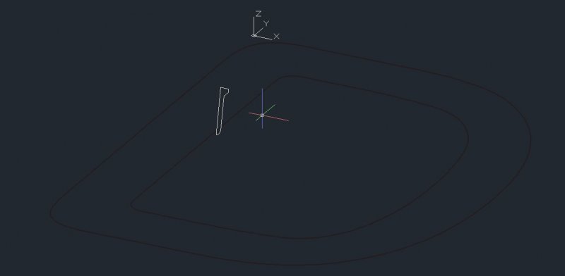

JD Mather Posted August 18, 2013 Posted August 18, 2013 Your path geometry is a spline, yet it could be simple lines and arcs. Use the most primitive geometry possible. If you use simple lines and arcs (fillets) joined as polyline your geometry will be smooth (and file size smaller). I would probably look at changing the modeling technique as well using the solidedit>shell function. Quote

lamensterms Posted August 18, 2013 Posted August 18, 2013 Robochrish - I understand how the tighter corners on the inside of your 'M' could cause some issues. A possible solution for this particular problem could be to initially model/create the negative space in your letters (the empty space inside and outside/around your trays) and SUBTRACT these negative space solids from another solid. For instance... You could easily create 2 straight solids to represent the inside of the vertical and diagonal segments of your M and SUBTRACT them to remove the excess around that tight corner. As far as the technique use to create your path... I'd say your best bet would be to use polylines and FILLET them at the radius corners (as JD) suggested. A filleted corner would create a single radius arc, which is a simpler curve than a spline. And should produce more logical results. Quote
