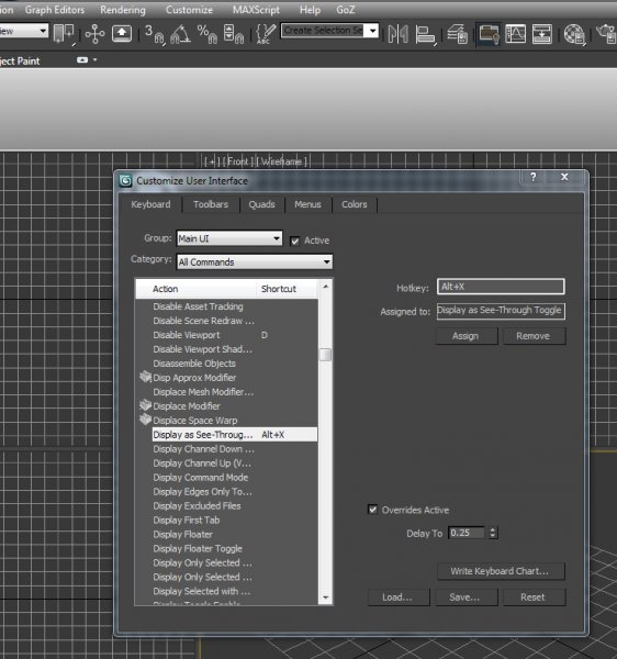

Then go to the "Customize" menu and select "Customize User Interface".
In the Customization dialog, go to the "Keyboard" tab and then scroll down through the command list until you get to "Display as See-Through". Check to see what "Hotkey" is assigned to this command. If no hotkey is assigned, just click in the "Hotkey" box and then press Alt+X to set it. Then click the "Assign" button, then click the "Save" button and save over your existing MaxStartUI.kbd file. Note: Make a backup copy of your MaxStartUI file before saving over it, in case you ever need to revert back to it.

I checked it out, it was already set up. I wonder why it doesn't work on my viewport, there must be sth going on as when I also use ActiveShade it doesn't work.
for the transparency I had to use your other technique of 0-100
Is your object selected when you hit Alt+X? Only selected objects will become transparent.
Also, what display driver are you using? DirectX or OpenGL? Go into your Preferences Settings, Viewports tab and click "Choose Driver". Whatever you're using, try using the other. I've tried both on my machine and they both work for me, but maybe there is an issue on your machine?
Actually, before you start messing with your display driver, go to the "Views" menu and select "Viewport Configuration". In the Configuration dialog, under the "Rendering Method" tab, in the "Transparency" section, make sure you're set to "Simple" or "Best", then in the "Apply To" section, make sure you're set to "All Viewports", then click OK.
