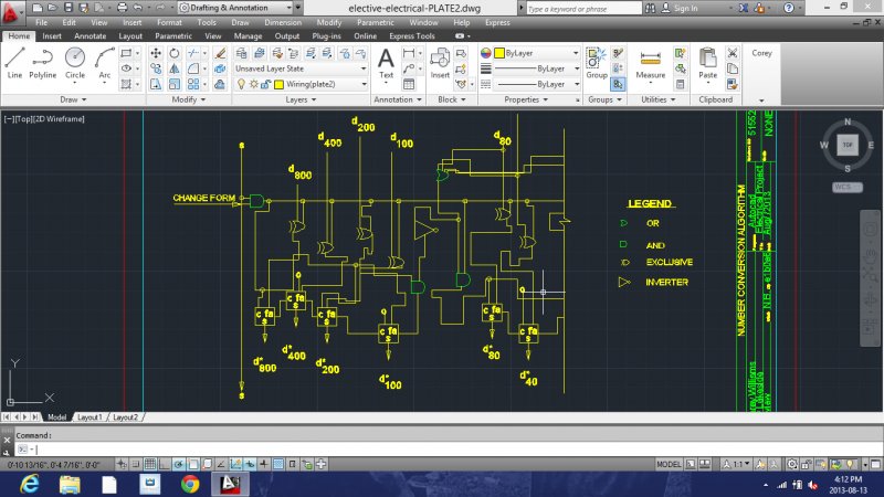

coreyjaywilliams Posted August 13, 2013 Author Posted August 13, 2013 this was my second plate, but frankly i dont care if its right or wrong, i wanted to finish this thing Quote

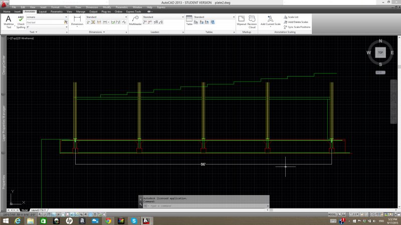

LANA211 Posted September 17, 2015 Posted September 17, 2015 And i really confused with roof and south elevation. This how my drawing looks right now so far... its what i tried to do... Quote
ReMark Posted September 18, 2015 Posted September 18, 2015 (edited) The first drawing you need to produce is the plan view of the foundation. After you have that completed that move on to the two elevations then the section. Have you created the plan view? If so, post an image. The instructions call for a shed roof (two foot overhang at front and rear but not on the sides). A shed roof is pitched in one direction. A simple Internet search on the phrase "shed roof" will yield numerous images of what one looks like. Because the roof is pitched the beams that support it will be pitched as well but it depends on how P-F elected to support the roof. I haven't completely read all the instructions. BTW...the slope of the roof is 1:10 and it pitches from the east to the west meaning the east end of the roof will be higher that the west end. It appears you have drawn your roof as a series of steps (one foot high and ten feet long) which would be incorrect. The roof should be a diagonal line dropping 1 foot in elevation every 10 feet of horizontal run. Usually pitch is expressed as a drop of X inches in elevation for every 12 inches of run (ex. - 1:12 or 3:12). Why P-F decided to express pitch in feet is a mystery to me. FYI: I have not taken the Penn-Foster AutoCAD drafting course nor have I attempted to recreate this particular structural project. Because the house is built into a hillside the foundation though is most likely stepped. It looks like P-F has not updated this project since I last viewed it five years ago. The project outline mentions saving to floppy disks (does anyone do that any more?) as well as creating a title block and border then scaling it up to fit the full size drawing (old school as in back when paper space layouts did not exist and everything was done in model space). This line from the instructions just makes me laugh. "Be aware that not all the information given here is necessary to complete the drafting project." What it should say is "Not all the information necessary to complete the drafting project is given here. We may have omitted something important or described something in such vague terms as to be confusing but we are too lazy to go back and rewrite the instructions." Why do I say this? Because the instructions are poorly written and in a couple of instances contradictory. I sent P-F an email about this project pointing out some of their errors and omissions but they refused to respond nor did they correct the instructions. Like I have said in the past they just don't care. P-F is basically a diploma mill that rakes in money and hands out nearly worthless certificates. I think if the long time, dedicated forum members here put their collective minds together we could write a better set of course instructions. Edited May 18, 2016 by ReMark Quote
